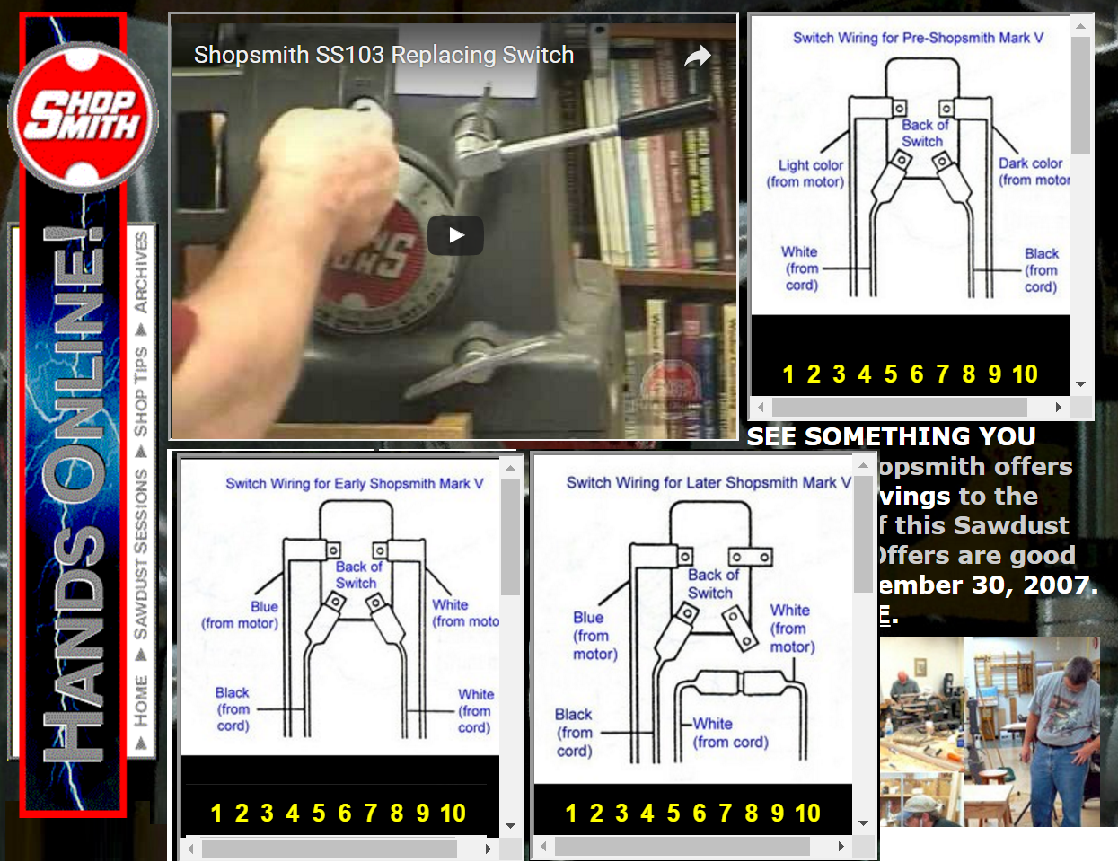

A while back there was a similar question and post about wiring a switch, and I either copied or created this picture, which summarizes the Sawdust Session SS103 for replacing a switch. It took me while to find the actual Sawdust Session (had to Google it to find it), as I couldn't seem to access it directly from the Shopsmith site.
http://www.shopsmithacademy.com/SS_Arch ... Switch.htm
While the video shows the process of replacing a switch, the 3 diagrams were shown on the "blackboard".
And again, thanks to anyone else who may have created the picture, if I copied and saved your work for future reference.

I find it necessary to APOLOGIZE for my mistake in saying all 4 wires were connected INTERNALLY. At my age, my mind isn't as sharp as it was years ago. After your last response,asking for the motor name plate, I removed the motor to take a photo. When removing the motor, I discovered there were only 2 wires (green & yellow ) coming from the motor & 2 wires ( black & white ) from the line cord. If you still need a photo of the name plate, I need to find out how to transfer photo from the camera too the message board. I believe the motor is 110v only & do have an ohmmeter. My residents is in Davison Michigan.
