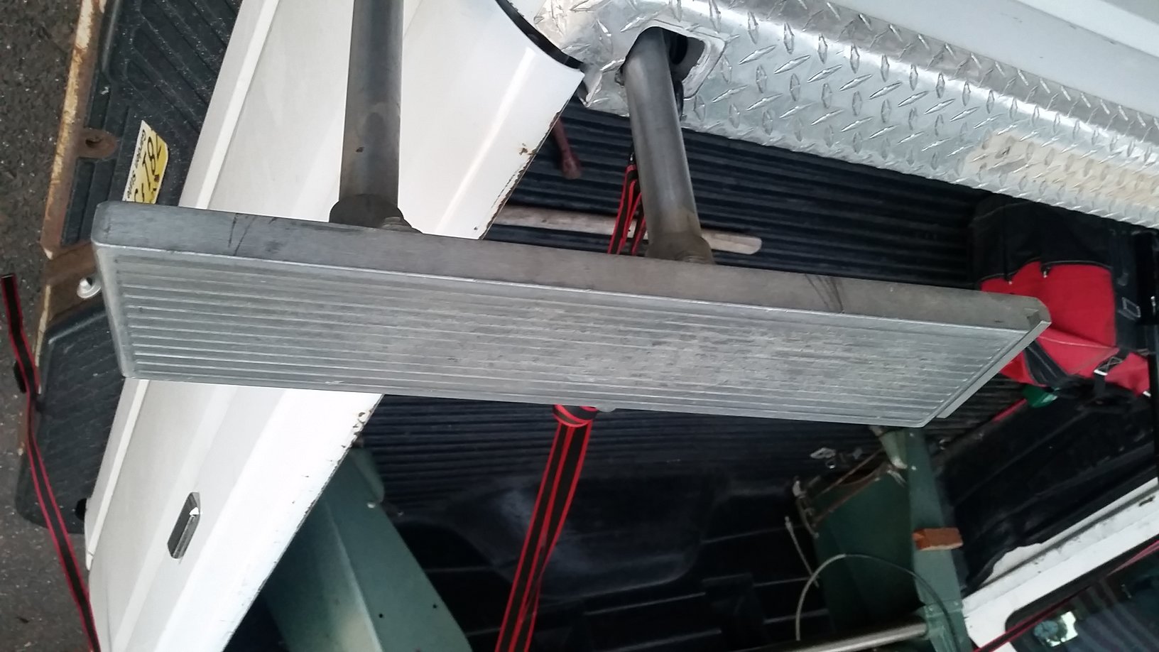

Re: Just got my first Shopsmith had a couple questions

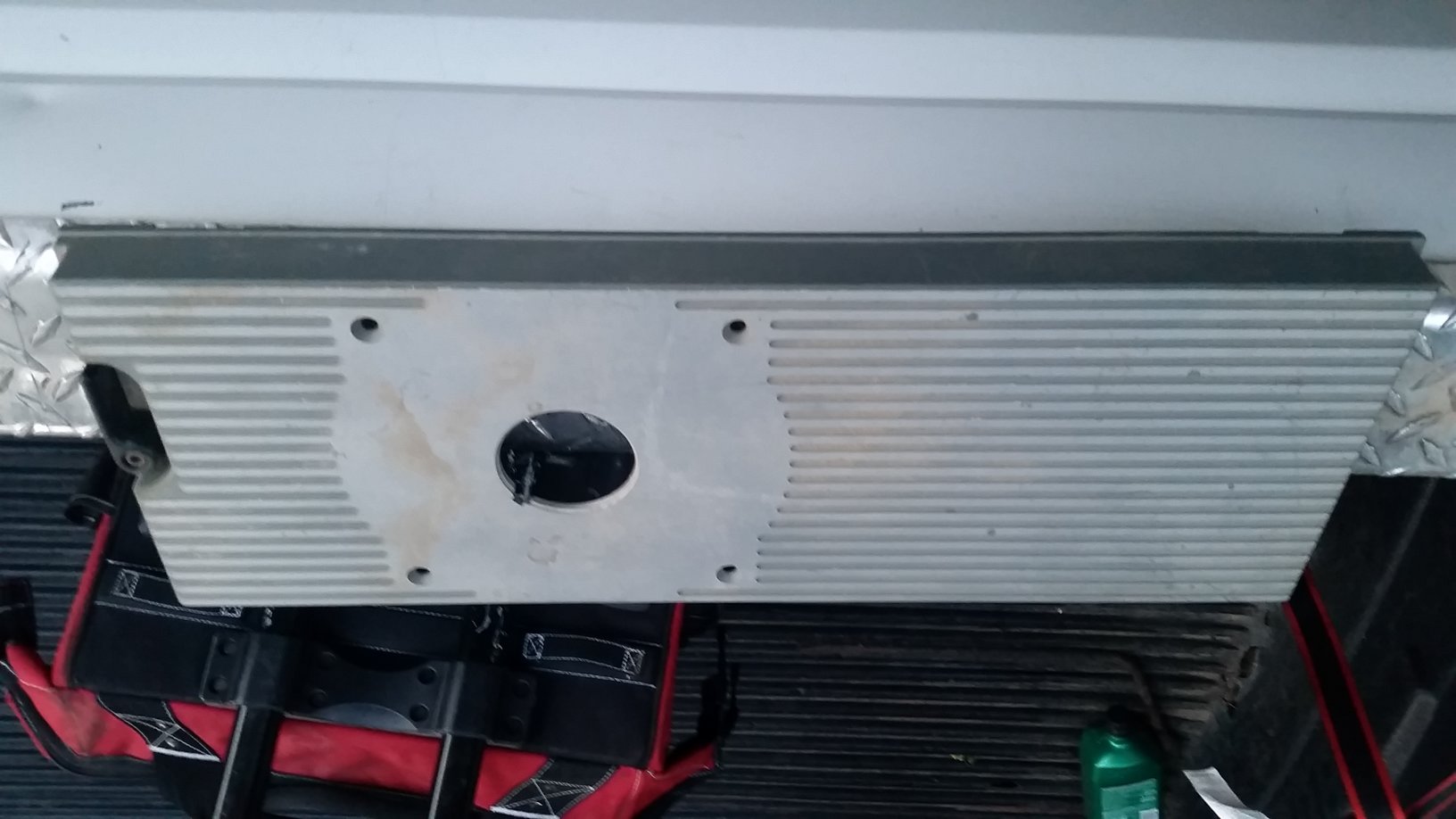

The table with the black lever on it in picture rsz_20180608_053548.jpg is an extention table from a Ryobi BT3000 table saw.

Oh, I thought maybe it was for using the router. I will try and find the right one.

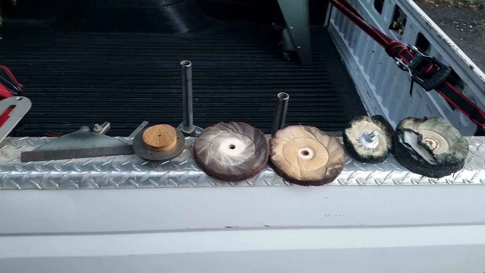

I noticed the Lathe Screw Drive is missing the Screw
A #14 x 1-1/4" Wood Screw is the size it needs
