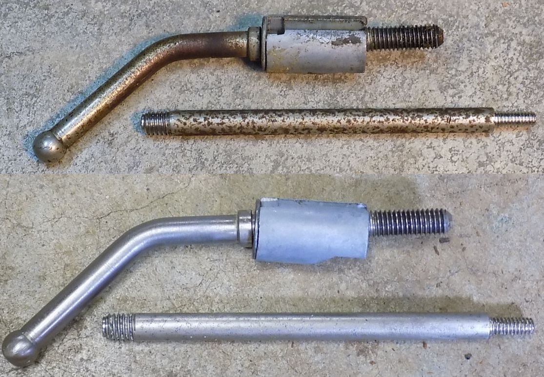

Thanks Russ and Everett! I've downloaded "Got Rust?" and will try the trick of raising the machine to the drill press position and soaking the arbor and spindle in Evapo-Rust to get the set screw out. That's the one piece that I've failed to budge so far. Here's a before and after photo from the second batch of parts to have an Evapo-Rust bath. These parts were in for 5 hours with temps in the mid 70s.

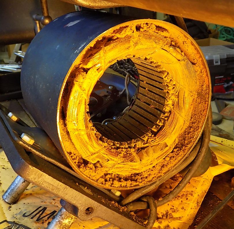

I opened up the 3/4 h.p. A.O. Smith motor yesterday to inspect it. It had a lot of sawdust in it, which I cleaned out. Other than that, it looked great. The bearing at the pulley end seemed to move slightly roughly, and I was afraid I might have to replace it. But after I lubricated it, it ran smoothly. This motor is HEAVY, much heavier than a modern 3/4 h.p. motor. It takes serious muscle to raise it into the vertical position. Does anyone have any tricks or gadgets to help raise a Shopsmith with a heavy motor?
