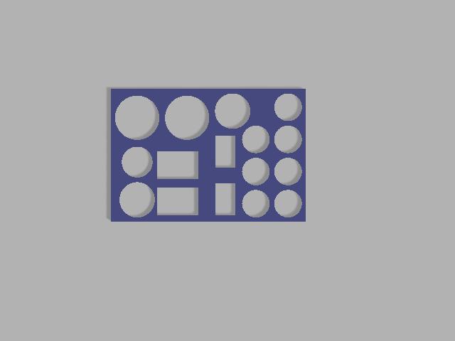

Here is a quick remake of the drawing "edible" put up done with Fusion 360 rendered to a jpg in blue shiny plastic. There is an underlying model so making changes to any of the object locations or dimensions does not require the user to start over.
fusion rendered jpg
fusion rendered jpg
instruments v4.jpg (12.73 KiB) Viewed 11943 times
