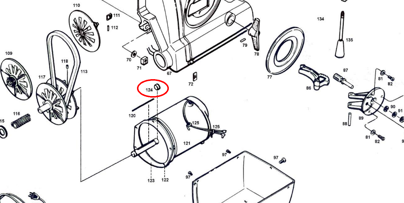

Take the fan pulley completely off while you are in there. Behind it there is (or likely should be) a slip on spacer between it and the motor. It can wear and reduce the space to keep the back from scraping.
Take a look at the setscrew indentation where it locks down and clean it up to smooth it out. That will help you put it back and get it secured in the right place.
Look at some of the exploded parts listings for more info.

everettdavis wrote:Take the fan pulley completely off while you are in there. Behind it there is (or likely should be) a slip on spacer between it and the motor. It can wear and reduce the space to keep the back from scraping.
Everett
This might help

Assuming it is the fan sheave rubbing, the spacer has a habit of embedding itself into the softer sheave. My suggestion(cheaper than a new fan sheave) is to slip a retaining ring between the spacer and the sheave.

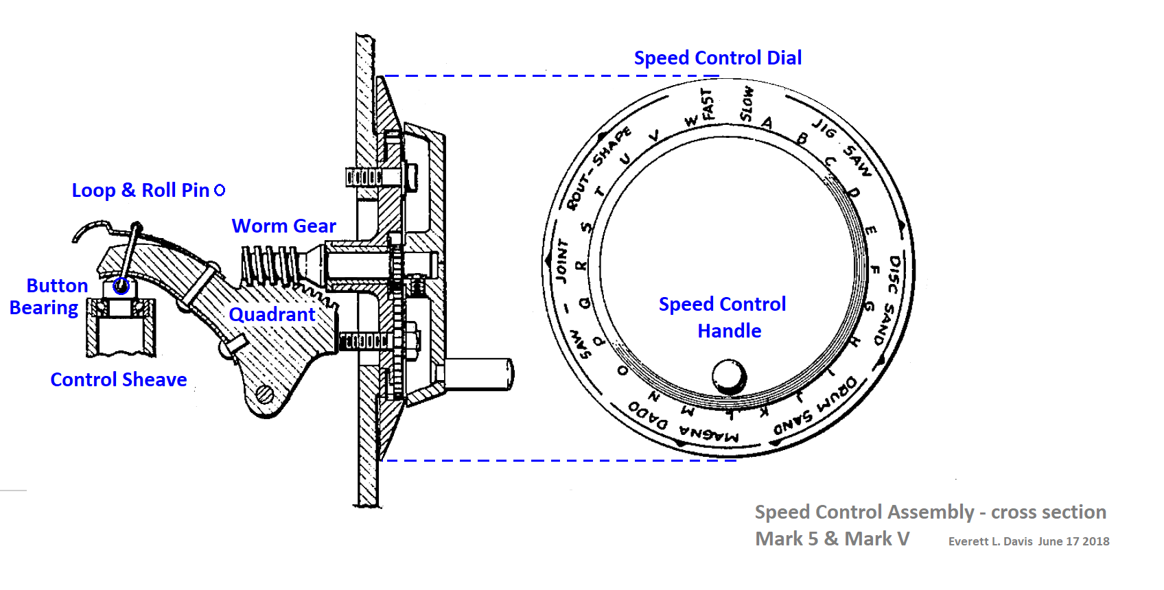

As for how it works, the control process begins with the speed control knob. Rotating the knob causes the quadrant gear(porkchop) to move the control sheave towards/away from the idler sheave. Those two sheaves are the halves of the idler pulley. By moving the control sheave, the effective working diameter of the idler puller is changed. When that occurs, the motor belt tension is changed. The pulley on the motor shaft consists of the fan sheave(fixed) and the floating sheave(moves). When the belt tension changes due to the control sheave moving, the spring loaded floating sheave moves to compensate and maintain belt tension(both to increase tension when the control sheave opens the idler pulley AND to decrease it when the control sheave closes the idler pulley). The movable sheaves(control/floating) move in opposite direction(one opens as the other closes and vice versa).
The movement of the control knob towards slow causes the control sheave to squeeze the belt. The floating sheave must move to open the motor pulley in response. If the floating sheave is slow to respond(gunked up) or the control knob is adjusted too rapidly, the quadrant gear can become damaged. That is the reason for the "DO NOT ADJUST SPEED UNLESS MOTOR IS RUNNING" warning. Also IF the floating sheave is slow to respond when adjusting the control knob towards fast, the anti-rotation clip attached to the bearing in the end of the control sheave may get pulled apart.

In addition to JPG's explanation above this may help
Everett
