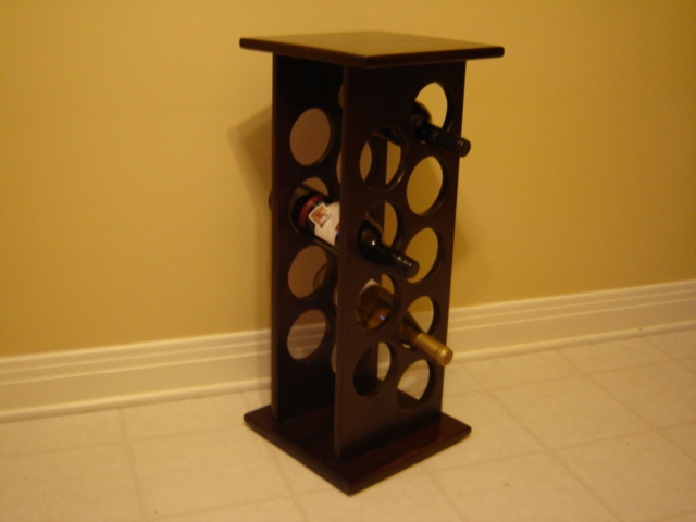

The wine rack is finally finished, but not without a last little hicup. After applying the coat of ebony stain to the top, I noticed all sorts of swirl marks from sanding. This after an initial sanding through four grades with the ROS, and then three gades by hand with the grain both before and after installing the screw plugs. Of course as usual, I couldn't just stop there so I applied the first coat of cabernet stain hoping it would reduce the marks. No such luck, so it was back to sanding through two coats of stain. The only good thing was it was easy to see when all the swirls were gone.

John, really a nice looking wine rack. Not sure where some of you woodworkers get your time from. Guess one of these days I will have to retire, then maybe I would have time t do some of these things that looks so beautiful.

Very nice looking wine rack, John!!!
Yes I have also run into those cross grain sanding marks, sometimes in swirls. After learning (the hard way) that stain or finish will not cover defects, I do all finish sanding with the grain. I also found out that wiping wood with mineral spirits will show the sanding marks you don't want. Then you can sand them out and wipe it down again. So it has become a common practice to first wipe with mineral spirits and letting it evaporate, before any finish.

You wouldn't believe the effort I took to avoid sanding marks. Besides hand sanding with the grain, I applied water to raise it and then sanded some more hoping that would help as I expected seeing marks with the dark stain. Obvioulsly I didn't quite sand enough. Oh well, as with the football game, "maybe next time".

John, the wine rack looks great! You did a fine job and that rack would look great in any setting.
