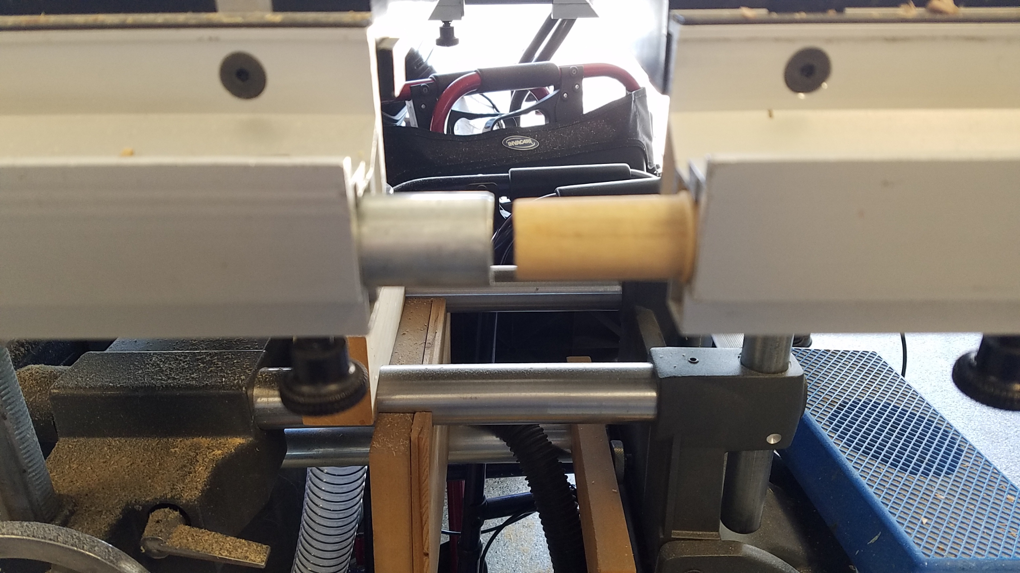

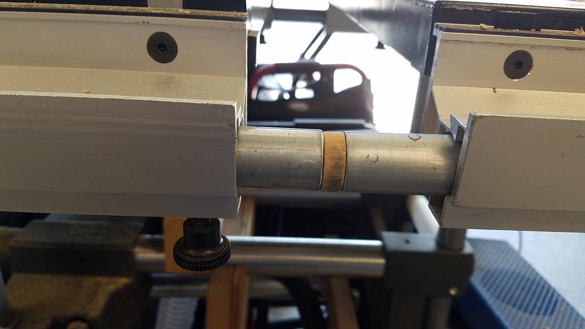

I can not speak for Dan but I DO NOT even attempt to raise or lower my Main Table with the Extension Table attached. I do. however, raise and lower the Main Table with my Outfeed Table and/or Sliding Cross Cut Table mounted.
I made a pair of wooden couplers for the Table Tubes to join (between the Main Table and the Extension Table). Thia allows me to disengage the Extension Table from the Main Table without pulling the tubes all the way out of the rails.

Not my best photo shots but these should give you an idea of what I did. I find that this simple solution works well for me. I normally do not tie the rear (outfeed side) end of the table together but this could be used there too.
I am having a pair of these, 8" long being made using aluminum bar stock.

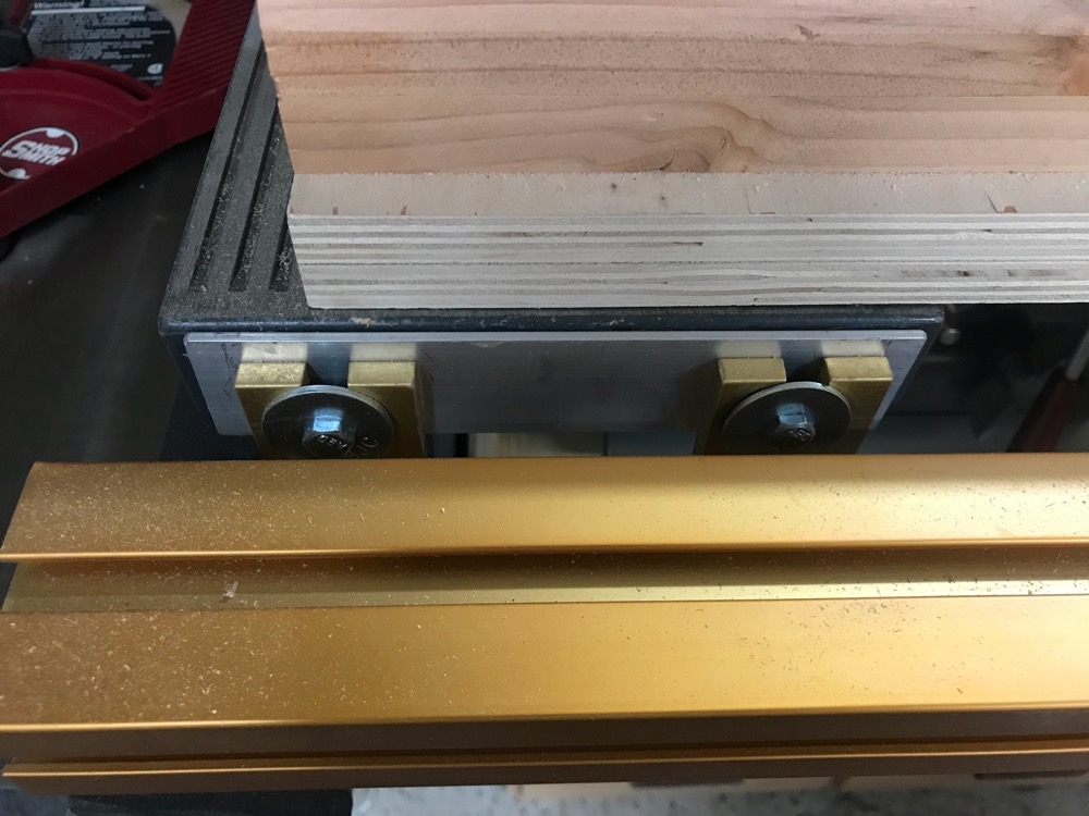

Paul, a few questions. What size bolts did you use to mount the rail system to the tables, did you use the same holes that are in the tables for the tubes, and what was the thickness and the width of the aluminum bar. Also, I saw you had some wooden shims ties to the tables what are they for. BTW hope you are recovering from your accident. Thanks; Mike

I used 1/4” bolts and aluminum spacer plates to mount the rails with oversized washers on the back. You will also need 8 more of the right angle mounting brackets from Incra. The aluminum spacers are from 1 1/4” flat stock I bought at HD. The wooden blocks are spacers I have used for years. I use them in conjunction with the stop collars to raise and lower the main table and the aux tables in unison at 1/4”, 1/2”, and 3/4” intervals. It is much faster than lowering the main table to a random place and then realigning the aux table. Order a few extra of the right angle brackets from Incra. I also have a router table that can be dropped in between the main and aux tables. This allows the use of the Incra wonder fence also which I highly recommend. Everything combined it adds a whole new dimension to the SS.
