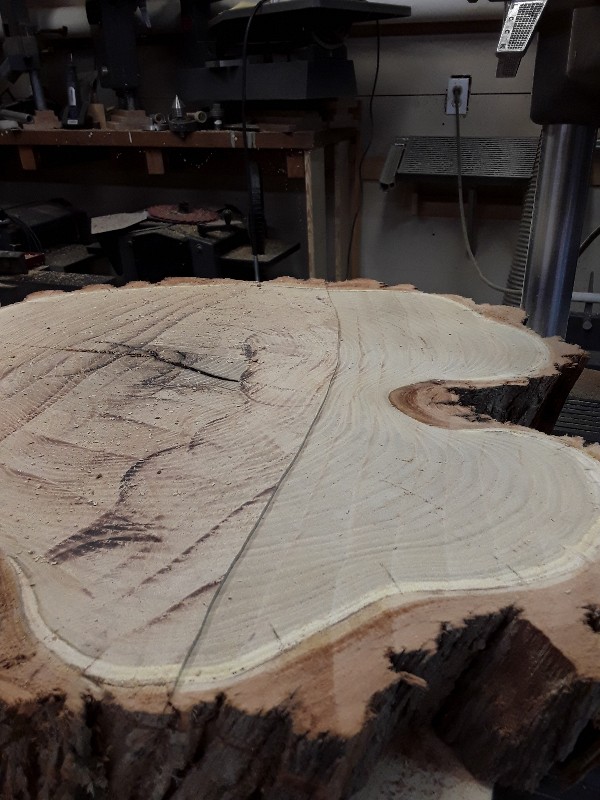

This was the safest way to plane this wedge down. It goes faster than it looks. About 1/8 in. at a time and this is locust that has been drying about 3 years.

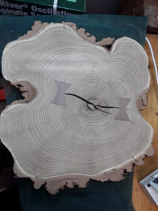

Ok, back to it.
Here is the difference between dull & sharp blades.
And I liked the angle on what will be the bottom so I'm replicating it on the other side.

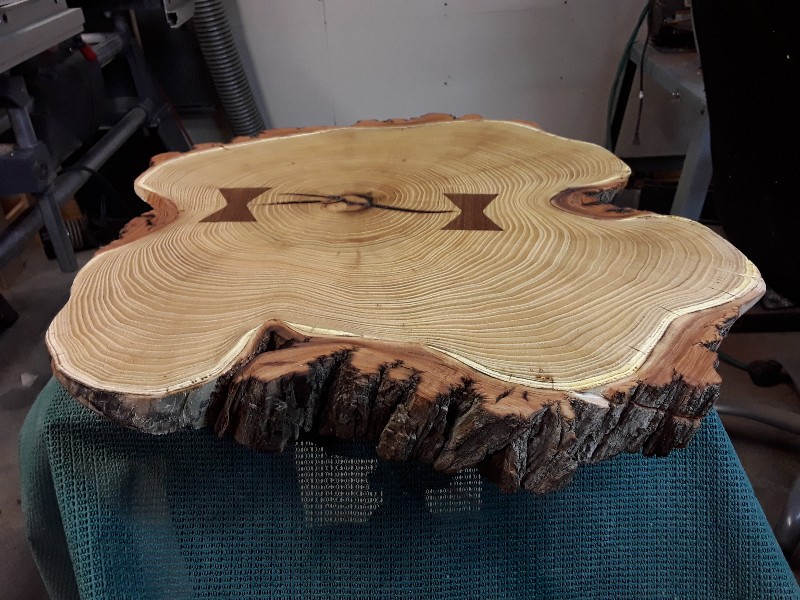

Project complete. Using butcher block oil. I dont know how long this piece will hold up but but its a good start at getting back into the project list.

Nice! The butterflies are amazing! Do you have a special tool for those or did you hand cut them? Also, would you consider filling that crack with epoxy?

The butterflys are hand cut. I route most of the waste with the router and finish with the chisels. That locust end grain is tougher than anything else I've cut into. Even just paring I had to constantly sharpen and the change in grain taught me a couple of things.
