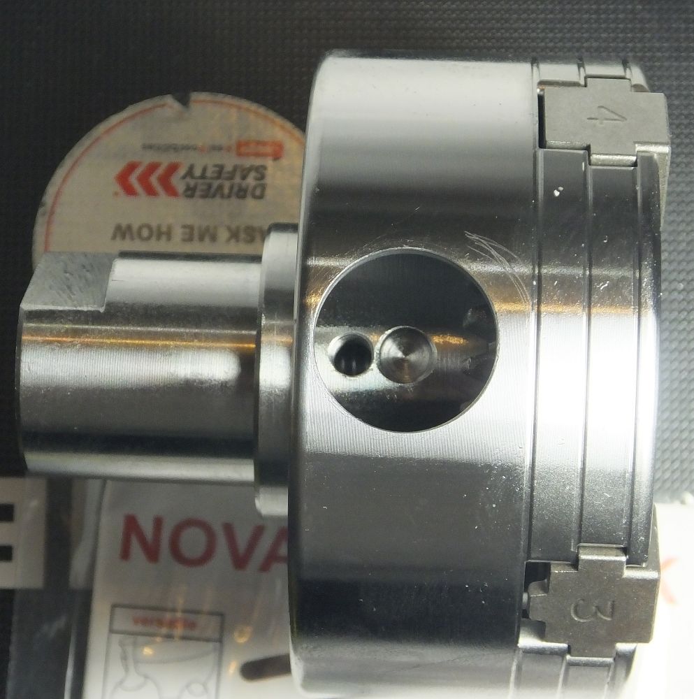

No, that is not what I wrote. The adapter stays on the spindle. It does have a set screw. The chuck spins off the adapter. With a bowl blank on, there is much inertia. The headstock stops fairly quickly and the chuck comes loose. I think Beeg is thinking of the chuck insert...
Now, I do have the correct insert for the Oneway Talon Chuck. That chuck never spins off the spindle.
Chris Neilan
ANNIVERSARY BUNDLE G3 CHUCK WITH PSI ADAPTER
Notice it HAS a grub screw!!!

Re: Lathe Chucks
Why is the fact that it has a grub screw being mentioned (highlighted)?
