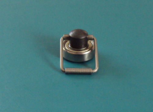

For whatever reason I forgot to include another source for the Sheave Button Bearing and Loop Assembly - Your sheave must be in good shape, and you must stake this bearing in place with sufficient material to keep it in place.
https://www.ebay.com/itm/SHOPSMITH-MARK ... 0EiYMvet9g
Everett
That link may change on eBay. Here is their site: https://www.ebay.com/usr/bandsaw-tire-warehouse
