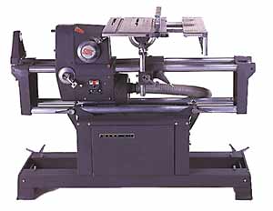

The old Mark VII was made in the 1960's and although you could find a good working one repair or replacement parts, if needed, are hard to find. The new Mark 7 is built on the Mark V with the addition of the Power Pro motor and Double Tilt ends and looks like a Mark V 520. The old Mark VII, new Mark 7 and the Mark V 520 are shown below.
Old Mark VII
Old Mark VII
MARK-VII_SS Inc.jpg (7.93 KiB) Viewed 32587 times
New Mark 7 with the Power Pro Motor
01_Model 520.jpg (28.14 KiB) Viewed 32587 times
If you are going with the Mark V as recommended there are several pluses. It is still in production and replacement parts if ever needed are readily available. The Mark V can even be up graded to a new Mark 7. When looking for a Mark V you will find them listed as Mark 5 which are the older ones made from 1954 until 1980 when the number 5 was changed to the Roman Numeral V. It is the same machine but changes/improvements were made over the years. Also the Mark 5 was out of production from late 1964 until 1973. The different Mark V models seen today have to do with the table/fence it has. The Mark V 500 is the original table/fence system. The Mark V 510 added a new larger table system with floating tables and a second Mark V the 505 came out at the same time without the floating tables. The Mark V 520 has the larger tables with floating ones and the Pro Fence. The Mark 7 uses this same Table/Fence system as the 520. Below are pictures of the different main tables.
