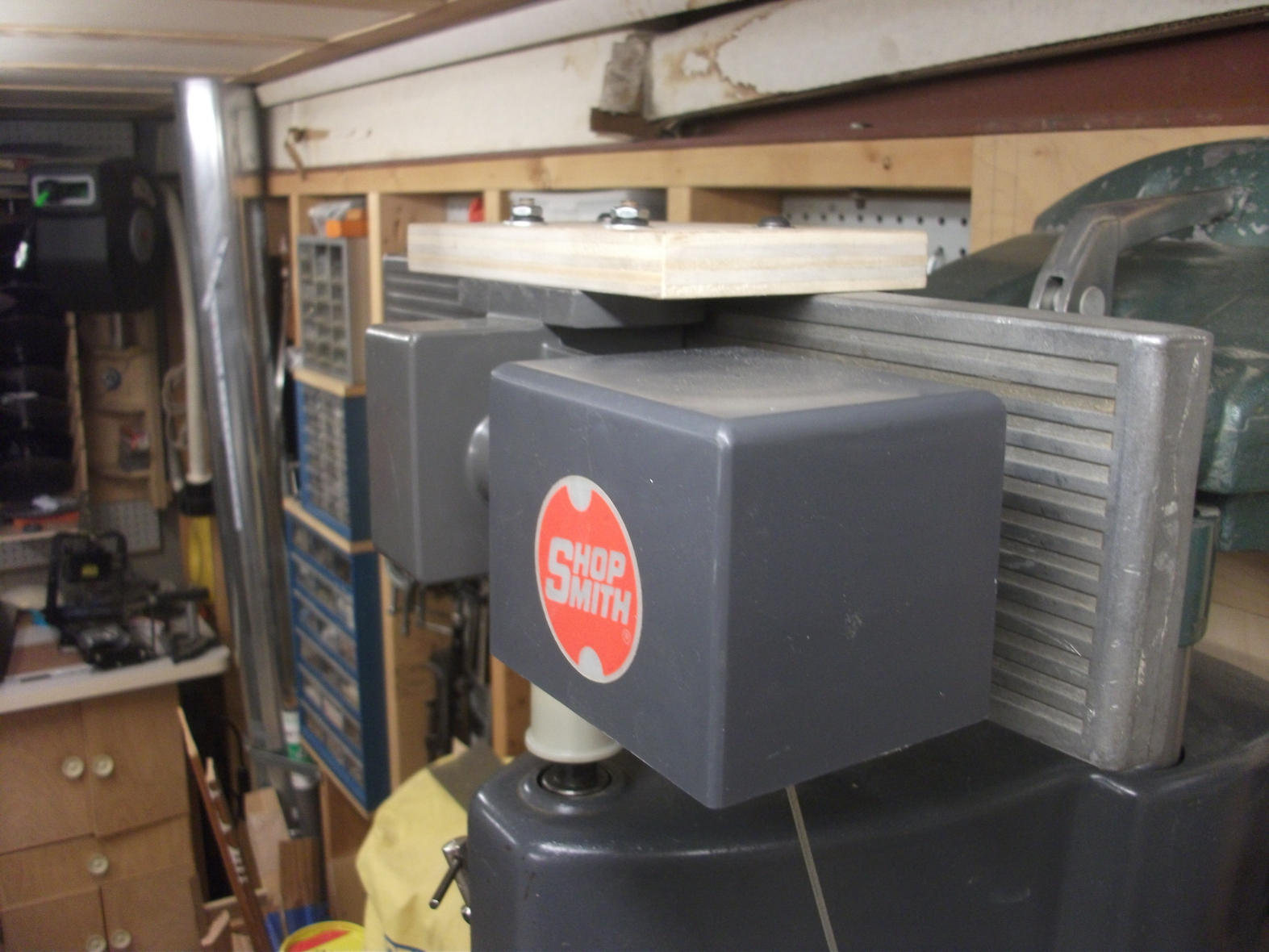

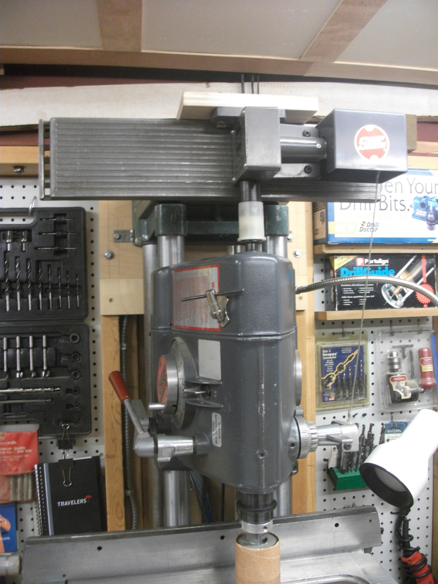

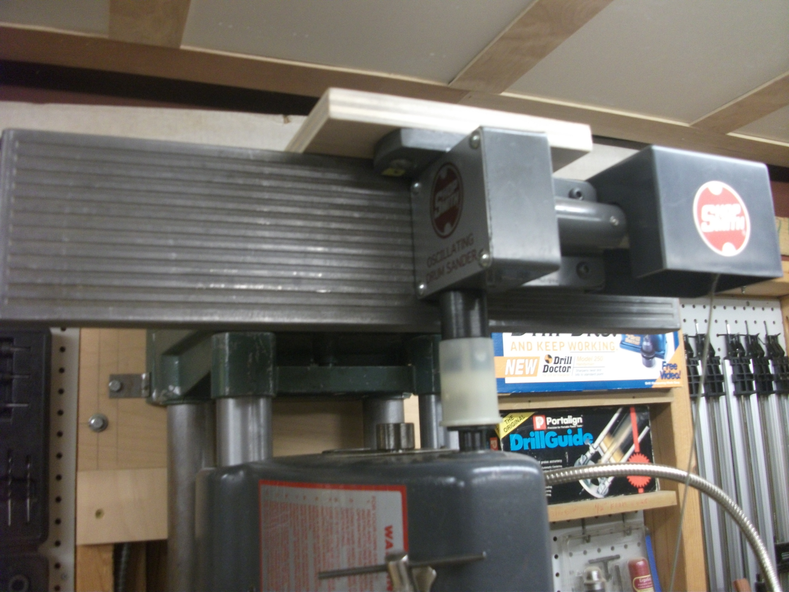

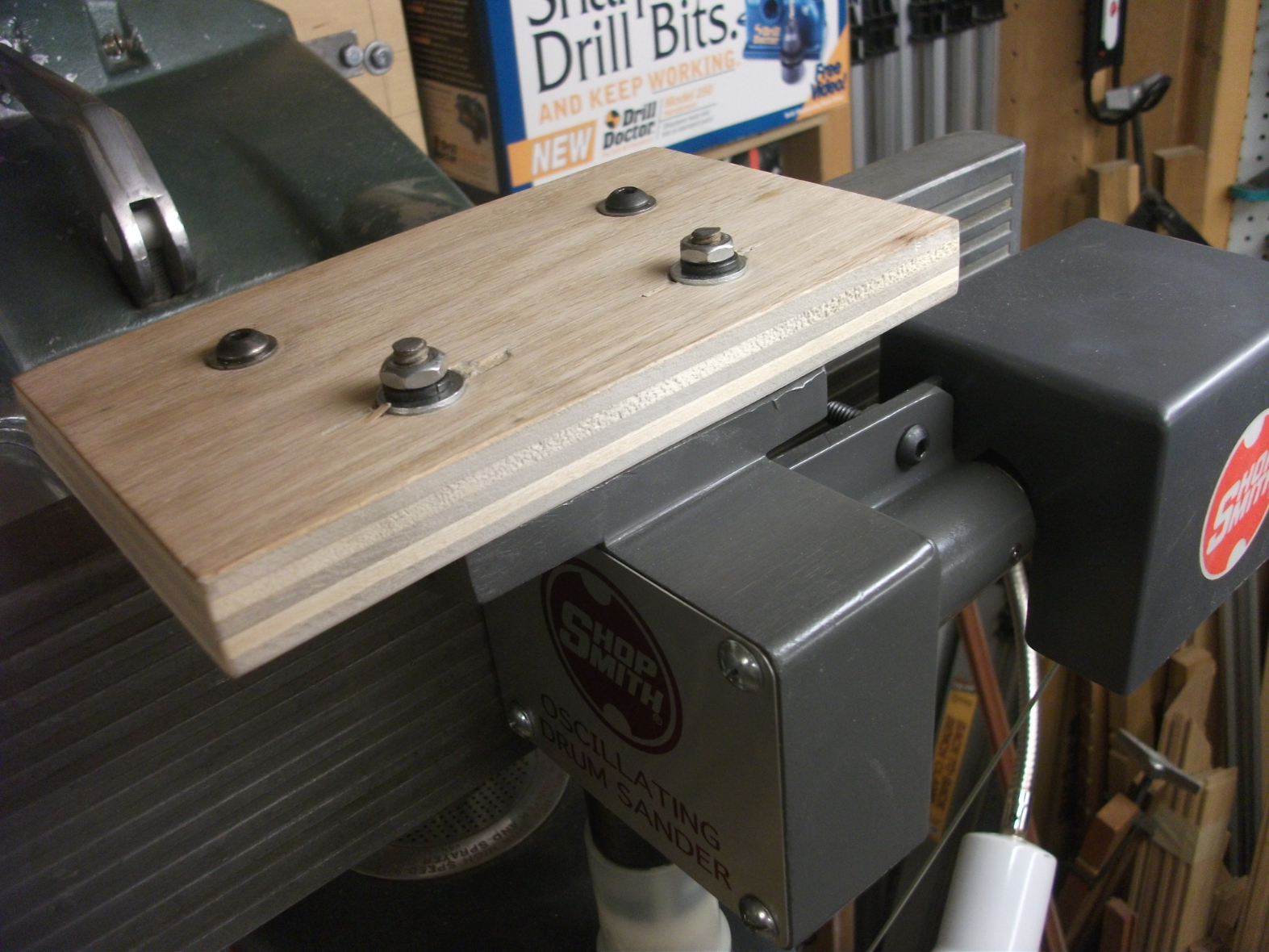

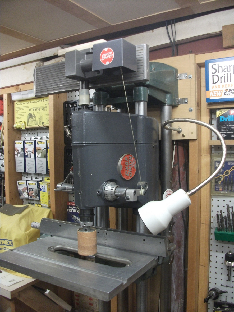

After messing around with the Osillating Sander I came up with a modification for those that have one of their SS permanently mounted in a vertical position. When I attached the OS the headstock had to be lowered about 8" and made the use of the drill press too low. I modified the OS attachment and moved it higher and mounted it to an extension table. As you can see this gives me in and out alignment with the extension table and then I slotted the attachment holes to give me side to side alignment. I drilled and tapped the side of the extension table for the mounting. This now can be mounted very easily with just the two screws and I do not have to mess with moving the headstock up or down when I want to use it. Works for me!
