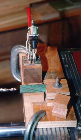

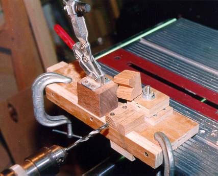

gk777
Posts: 52
Joined: Sun Apr 06, 2008 4:03 pm
Location: Delaware
Post by gk777 »

Pictures of drill jig
Post by gk777 »
[[attach]2507[/attach]
[attach]2508[/attach]
[attach]2509[/attach]
[attach]2510[/attach]
