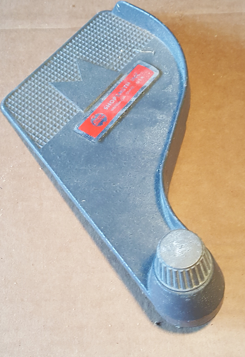

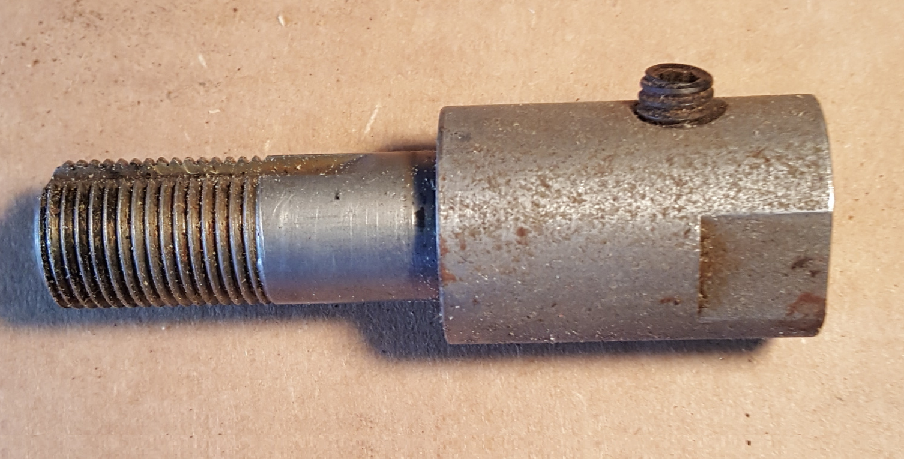

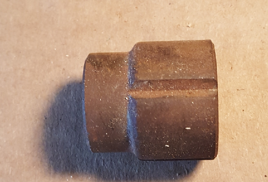

BobCoates1953
- Posts: 108
- Joined: Sun Jan 14, 2018 12:08 pm
- Location: Norristown, Pa
Re: trying to find parts numbers
Don't know if this helps but don't have part numbers, but first is tool hub(or for on the head) for a power mount adapter. Second is a arbor for saw or grinder etc missing nut add washers. Last is cutter guard for the jointer.

Part 1 is the Upper Drive Hub Assembly (includes set screw), the current part number is 503570. Yours looks to be a older one maybe from a Greenie or Goldie Mark 5. It may have came from the Power Mount Coupler Kit P/N 22 001.
Part 2 is P/N 22 031 the 5/8" Arbor missing the machined spacer, 2 machined washers, keyed washer and nut. Made from 1954 to 1964. In 1964 this arbor became P/N 505506 (version 1) named the 5/8" Universal Arbor and the black protective coating was added. The current 505506 (version 4) is now the 5/8" Molder/Dado Arbor.
Part 3 is P/N 502653 the Cutter Guard Assembly from the older 4" Jointers. Yours would be from sometime between 1973 and the early 1980's. These guards still had the Magna "M" with a Shopsmith Inc. sticker. This guard has been replaced by the current Jointer Feather Guard and can be bought as a retro fit P/N 555480.
