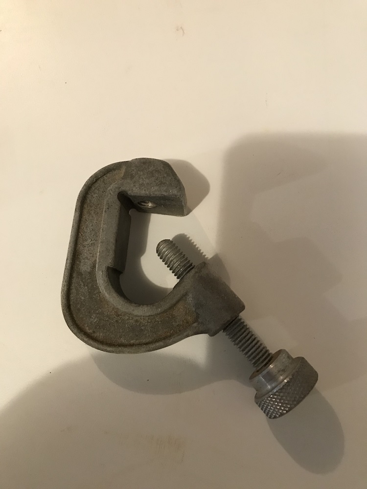

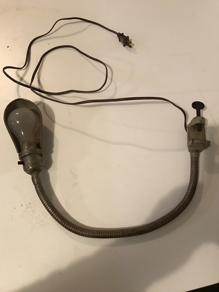

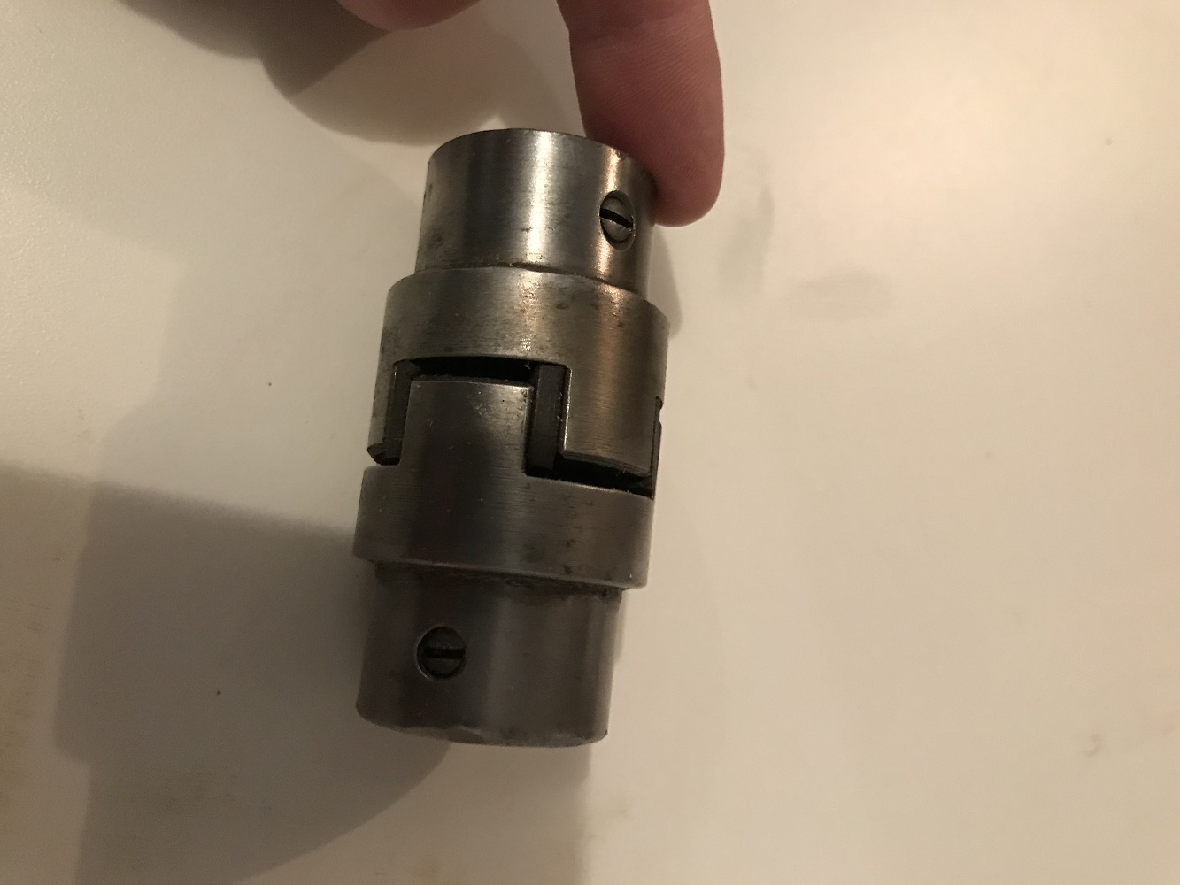

I have a few items that came with a 10er I bought. I can't find them in any of the paperwork I have. I'm hoping someone can tell me if they are Shopsmith accessories or some other brand.
Lamp
Lamp
Shopsmith lamp.jpg (151.2 KiB) Viewed 11021 times
Clamp
Clamp
Coupling
Coupling

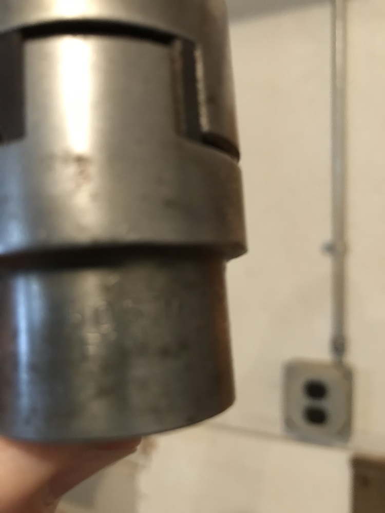

Coupling close up
Coupling close up
Coupling close up.jpg (104.53 KiB) Viewed 11021 times

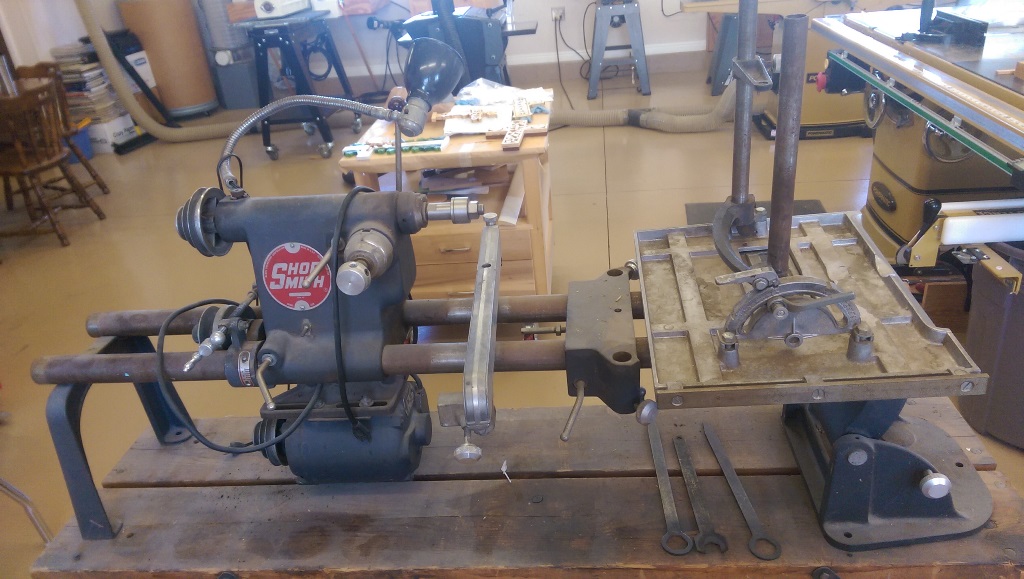

The lamp is not Shopsmith. You can see a SS lamp in the attached picture.
The second picture I believe is a clamp from the Magna set of stock hold downs. Someone will correct me if I am wrong. :)
The third picture is the flexible coupler used to connect the A-34 jig saw to the 10ER spindle.

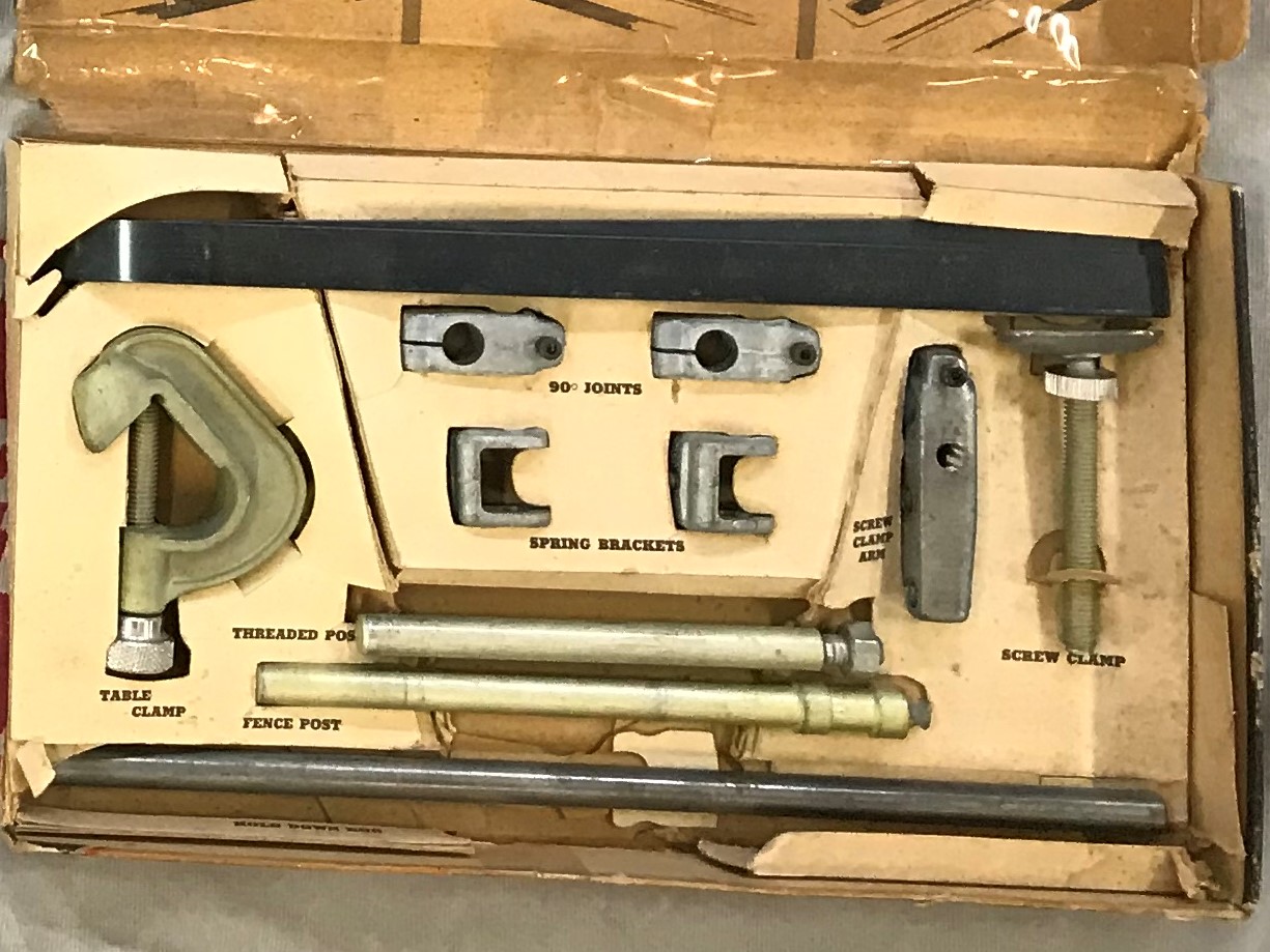

John is totally correct on the first two. The clamp is shown below.
Universal Hold Down
Universal Hold Down
The Third item is not a Shopsmith/Magna part but if it is the correct size is a substitute for the coupler to connect the Jig Saw to the Model 10's spindle.

That is what I thought but forgot to mention it. Lovejoy makes couplers today that will work.

donpol,
I should have been clearer before. From the other pictures I see one end has a sleeve in it. To work as a replacement for the coupler for the Jig Saw on a Model 10 it needs to have a 5/8" bore on both ends. The original coupler is 1-7/8" long and 1-3/16" diameter. Sorry I did not give you these dimensions before. If a replacement is too long, to large in diameter or has the wrong size bore it will not work.

The Lovejoy coupling works. I got one "just in case" the original fails for my son.
Info from sale receipt:
2 required: L070x .625 1024 These have a keyway but not really needed.
Bore 5/8 hub od 1.36 max rpm 3600.
1 required: L070 10406 spider solid center
Since there are 3 pieces I put clear duck tape around them (so son won't loose them :) ).
Test fitted and ran, didn't see any problems
Cost was less then 20.
