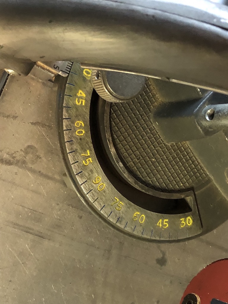

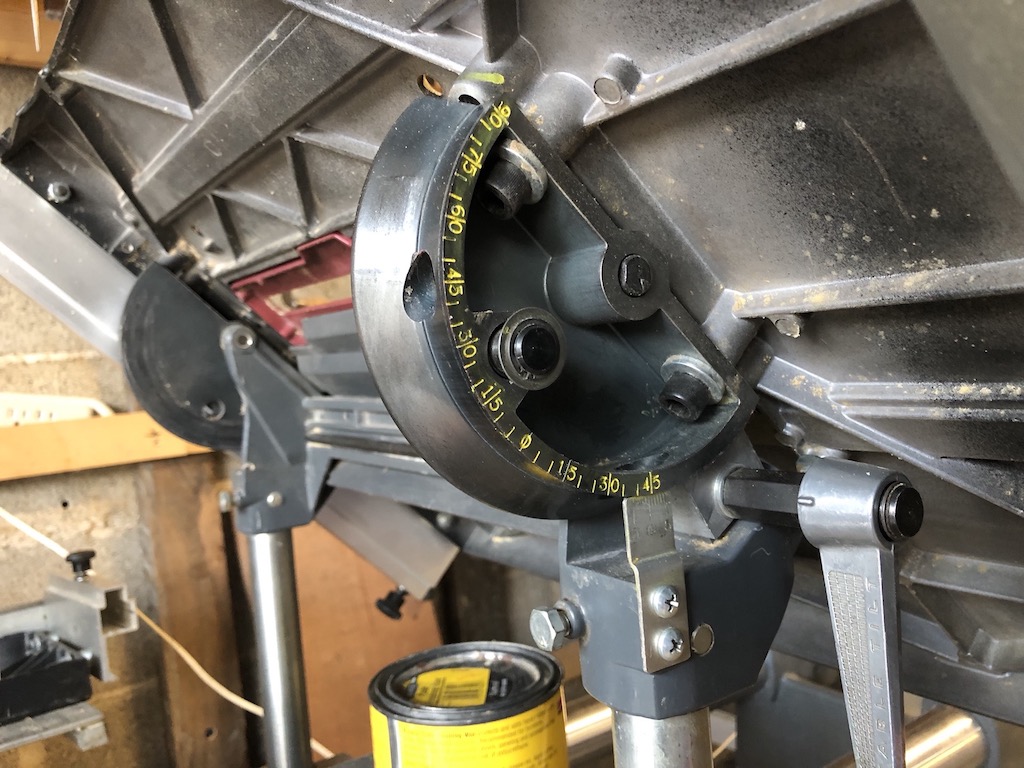

Thanks for the answers everyone, it's working great now. I backed off both nuts maybe 1/8 of a turn, waxed the fence, and then waxed the Shopsmith. I realized I've never waxed the trunnions, so I did that as well. Since I have a dark-ish garage I took a paint pen and highlighted the trunnions and the miter gauge so I don't have to stoop and squint.
Painted trunnion yellow
Numbers are yellow and blue for the tick marks
