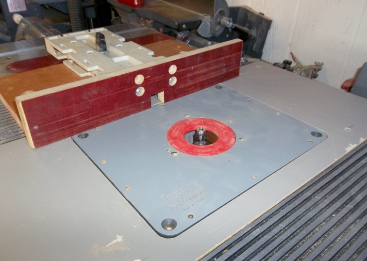

I have just completed a router table jig for my SS 520. It has been a project I have wanted to do for several years. I stopped at an estate sale and found a JessEm router table insert, so no more excesses.
This is my version of a Shipwright design. If I am disremembering I apologize to whomever originally posted the design.

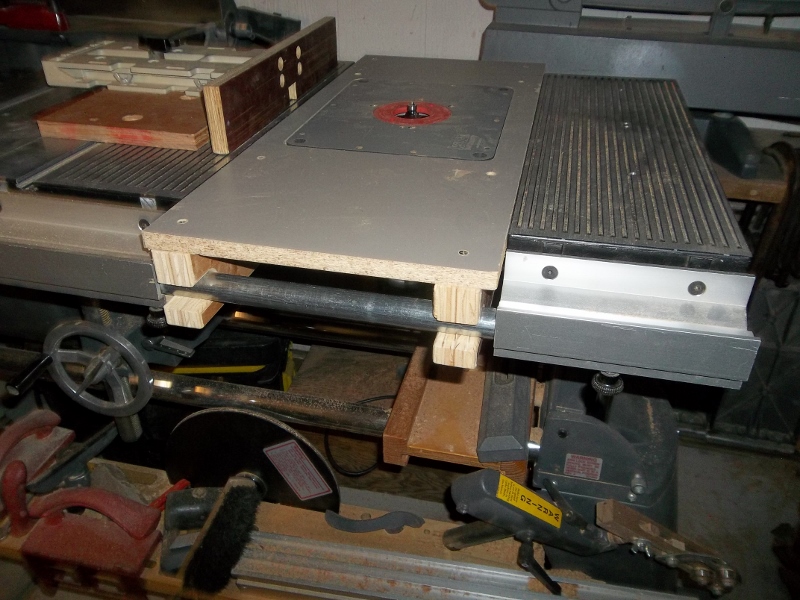

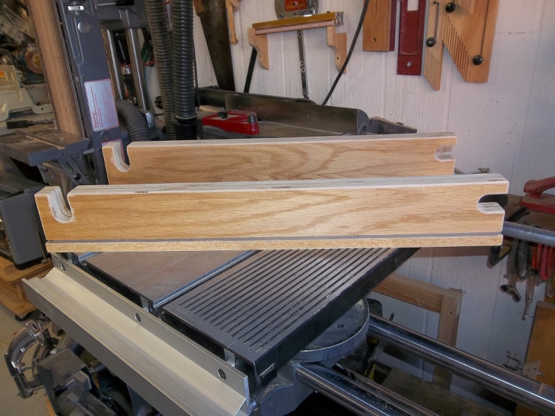

As a note: There are small bumps on the mounting bracket dwells so the jig cam locks over the tubes to keep the jig from moving during use.
SS 520 router table
SS 520 router table

Sweet! I especially like the sub-base configuration for the Original Incra Jig.

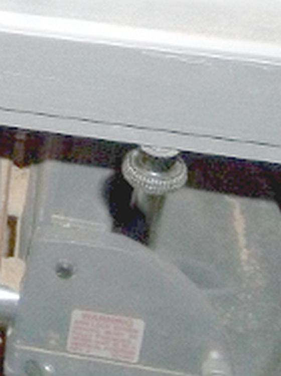

What’s that black thing that you have supporting the outboard table? In the pic, it looks like you’re using a floating table, rather than an aux. table with the mounting posts.

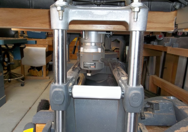

Looks good. What size/brand router were you able to fit and not hit the tubes below?STB wrote:I have just completed a router table jig for my SS 520. It has been a project I have wanted to do for several years. I stopped at an estate sale and found a JessEm router table insert, so no more excesses.

I think I saw the same thing when I first looked at this picture too. On giving it a second look, I believe he does have an auxiliary table in place. The picture is a little dark, so the shadows make it look like the auxiliary table tube is darker. Combined with the plastic knob above it from the fence rail makes it look deceptively like a different mount.BuckeyeDennis wrote:Sweet! I especially like the sub-base configuration for the Original Incra Jig.
Re: SS 520 router table
Aha!!!

[quote="RFGuy What size/brand router were you able to fit and not hit the tubes below?[/quote]
The router is a 1hp Craftsman and the base is a Porter Cable. The craftsman base is sort of oval and does not fit the insert. The router fits between the tubes just fine. I mounted the router as far forward as I could.
