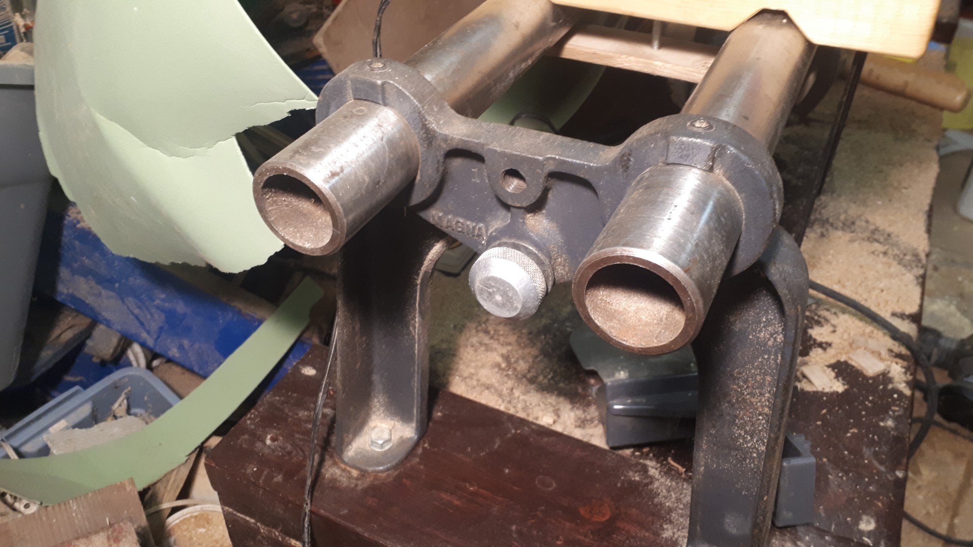

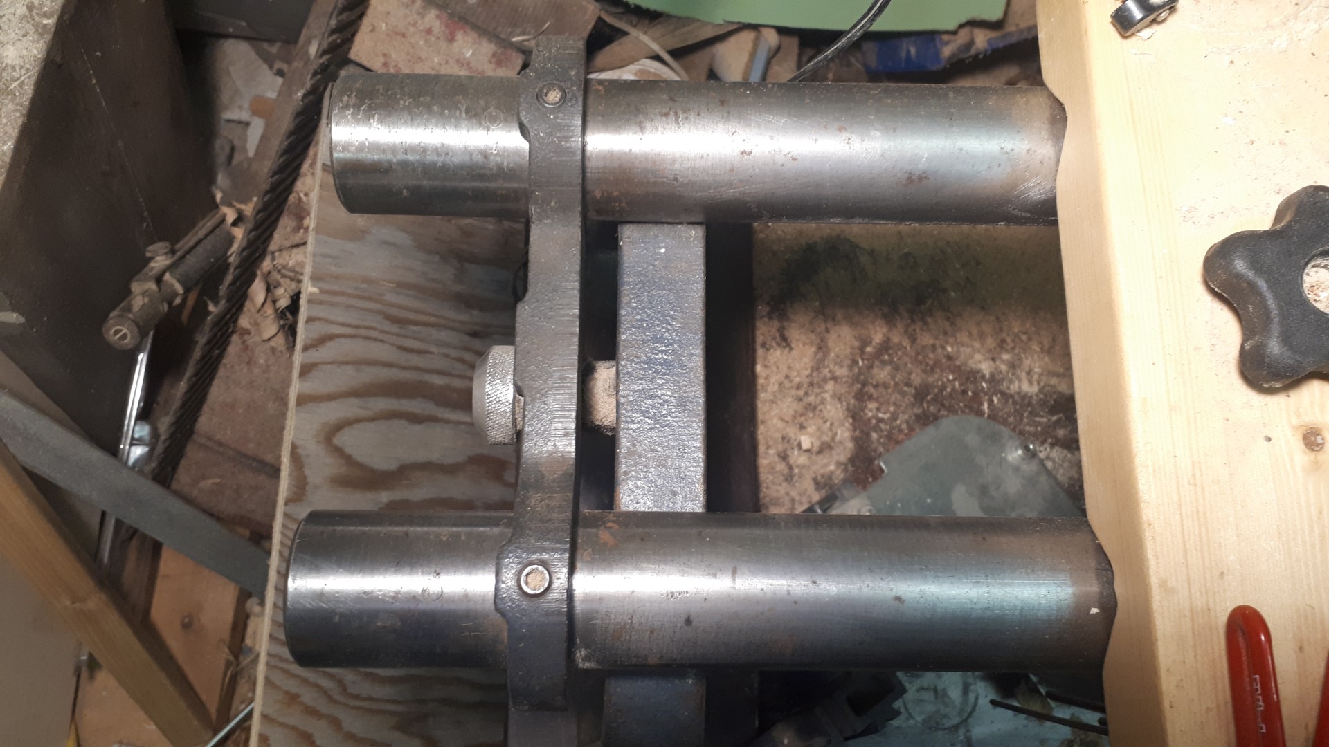

2. Though it doesn't matter in a permanently verticle position, can someone please photo and explain the tie-bar (C2267), headrest (D2268), knob & stud (101 310) interaction? This gentleman had the tie bar on, but the way tubes were just resting on the headrest (he even complained of it being hard to slide the headstock or carriage because the way tubes would slightly spread and it would bind). I know he had that configured incorrectly (and I don't know if the part I found in the box he gave me was 101 310 or not), but after reading the owner's manual, it still isn't abundantly clear to me how those three pieces should interact. Pictures show tie bar outside the headrest. Exploded view makes it look like it could be the other way around. Is it just resting on that stud or do you tighten it down? What is the tapped hole in the middle of the tie-bar for?

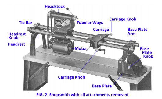

A picture is worth a 1000 words they say.
Magna had it configured as illustrated in the photos.
The hole is for the Headrest knob
The tapped hole may be used for a place to put another accessory table in place using another knob if you have the longer extension table.
Bill Mayo told me of another use but for the life of me I can't remember it now.
The base arm and the tie bar (outside) have way tubes extending allowing the auxiliary fence to be located at either end. When you have two of them, you can put an extension table on both ends to cut larger sheets (with help to support the outfeed)
No clue why it binds unless the way tube has some rough spots where it was over tightened. Smooth them out if that's the case.

The tie bar goes to the left of, and adjacent to, the headrest. The knob/bolt holds it in place, but not super securely, gravity does most of the work.
Here are pictures from the end.
and the top.
