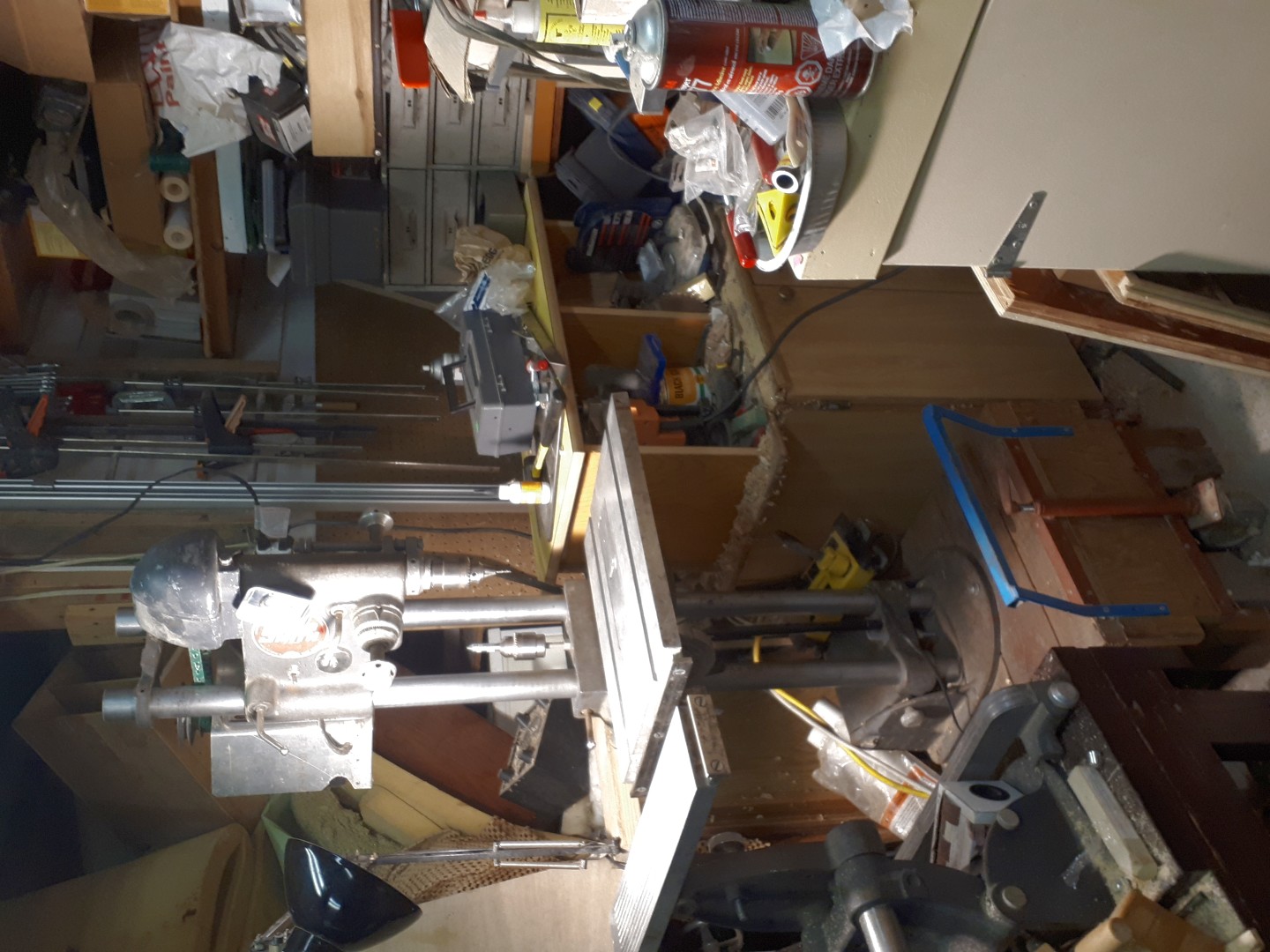

Some time in 1950, probably spring.
I have #23430, older than me too, but only by a couple of years.

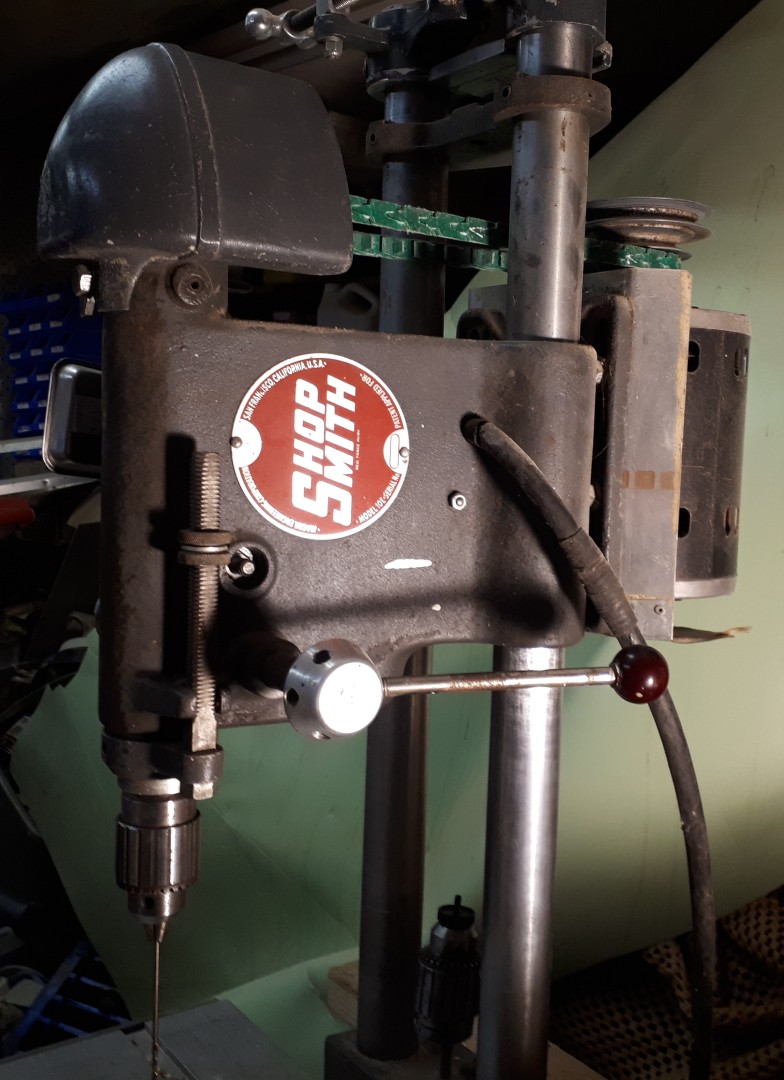

It is a bit special as it is part of a run made for demonstrators to use and has a second logo plate on the back (customer) side. I am curious if yours has the second name plate also, as they are so close together. :)
Please post pictures, we love pictures. :D
This is mine, this one is my dedicated drill press.
drill press.jpg (287.21 KiB) Viewed 11613 times
And the back side showing the second logo plate.
