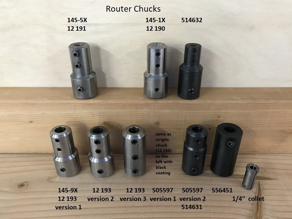

In a recent post I included a picture showing the Shopsmith arbors that was incomplete. Below are pictures of all the Shopsmith arbors I know of except the 1/2" Router Chuck P/N 505597 version 1 and is the only one I do not have. Also posted here is the PDF I created listing all the arbors plus additional information. I believe this list is complete.
Router Chucks - labeled.jpg (226.53 KiB) Viewed 34367 times

I hope this information is helpful in identifying arbors for the Shopsmith tools. If you find any errors let me know so I can update my lists.

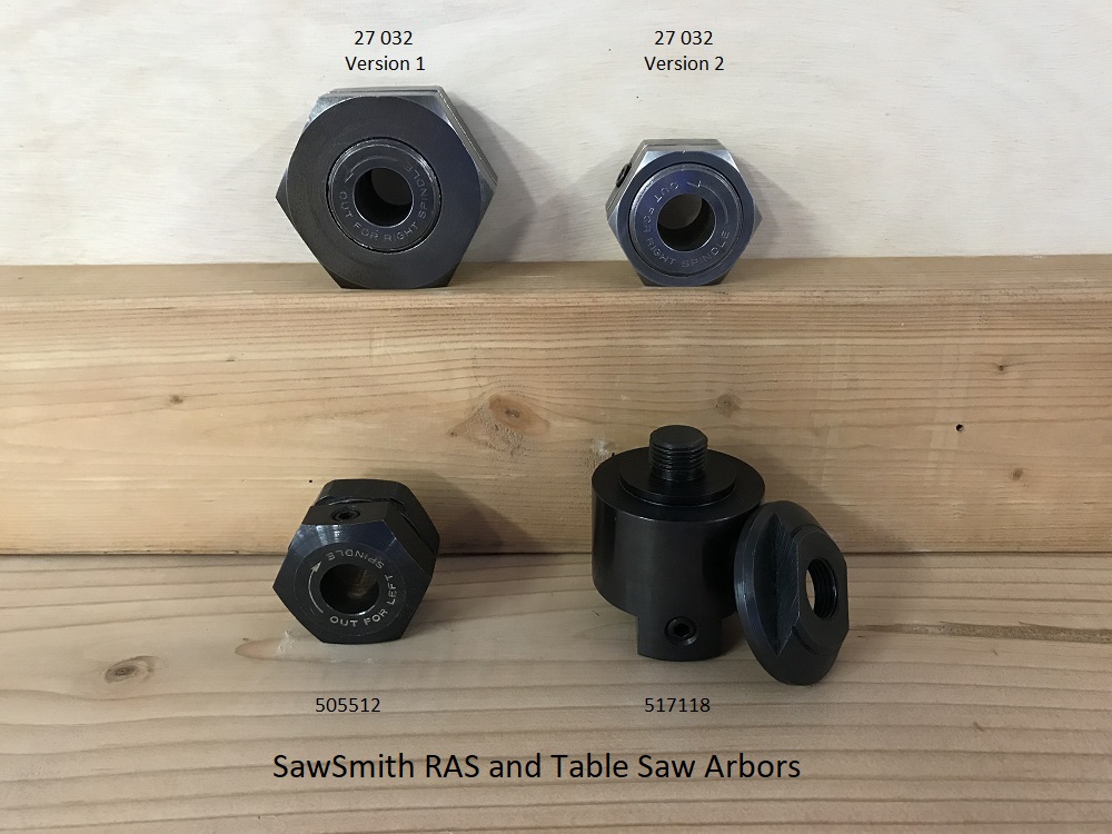

Below, for reference is the Sawsmith only arbors. The three hex nut style were for the RAS and the other that looks like 555608 was for the table saw it was also P/N 555572.
SawSmith Arbors - labeled.jpg (210.32 KiB) Viewed 34367 times
