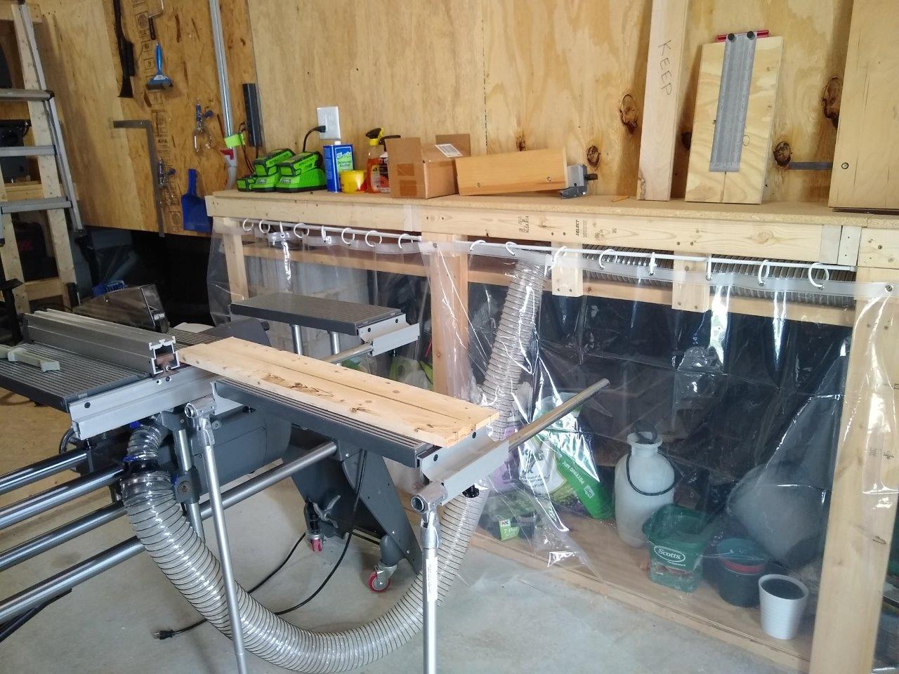

I wont give guidance, but I will tell you what worked for me..hopefully something useful can be gleaned from it for your application.
I have a Jet 650CFM unit with about 10-12 feet of 4" flex tube terminating on the tool with a 3 or 4 inch long , 2.5" diameter hose for quick disconnect/reconnect on the various ports on the tool.
This works fine for me..havent observed any clogs/poor suction. For table saw, router, jointer, band saw use. The Jet unit is just off camera on right of pic.
IMG_20190516_105534346 (1).jpg (198.76 KiB) Viewed 13598 times
Of course, a min/max vacuum guy would tell you :
1) Shortest possible run between pump and port
2) Hard tubing rather than flex with biggest diameter possible
3) Avoid sharp bends
I intend at some point to upgrade to hard tube, but as I haven't seen an issue with this config, I've been lazy to move forward.
