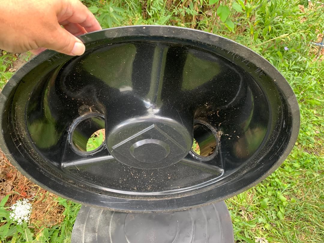

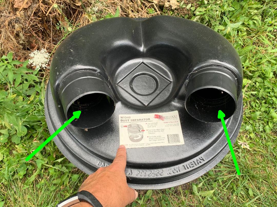

Re: Dust Collection needs - new shop setup
I have had one of these for maybe 20 years. It fits the top of a 20"dia. garbage can. I don't always use it as it works better at chips then thing like sanding dust.
I did make a minor modification to mine, the ports were just holes that you stock the hose in but I added some hard attachments to make it easier for me to use.
dust one.jpg (267.87 KiB) Viewed 25814 times
dust two.jpg (199.71 KiB) Viewed 25814 times
