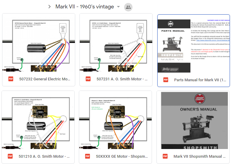

I can help with that just a bit. https://www.shopsmith.com/ss_forum/view ... 90#p185690beeg wrote:YES!JPG wrote:beeg wrote:You don't need to pull the headstock. Just undo the nut holding the switch. BEFORE ya disconnect the switch, take a pic so ya know where the wires go back to.
ALL 8 or nine wires????
or the next question will be "WHERE do these wires connect."![]()
Follow the My Google Drive link, select the "Mark VII - 1960's vintage" folder
When you start seeing things like these..... download what you need. It's Free
There are even some blank motor wiring diagrams in case your colors are different that allow you to define what you have. Pictures are good, but colors sometimes get sketchy.
