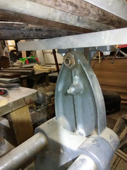

Well by Golly, Yes. Even that roll-able table its mounted on! My pix are from my phone & just a tad bigger then allowed. How much does that sucker weigh? It`s setup as a table saw, but Man-o-man did I look for other parts. I was really hoping to find the equipment for the lathe, especially that tool rest, no such luck though. I`ll see if my wife or 2 daughter`s can "shrink" my pix. Thank You Very Much guys!!
Re: New owner of a Shopsmith, took me a while.
- Copper pipe piece in the tail stock?

The Lathe Tool Rest parts come up for sale regularly on ebay. Remember when looking the Arm and post are different for the Model 10's than the ones for the Mark series tools. The Tool Rest part is interchangeable though. Remove the copper pipe piece from the tailstock so you can use it with the standard #2 Morse taper centers.

Thank you chapmanruss! So mine is a model 10 ER?

Yours is a Model 10ER. When Magna Engineering Corporation, the original company to make the Shopsmith, changed the model from 10E to 10ER they didn't redo the Name Plate to allow enough space for 10ER where 10E was so they just put ER on it. Later the Name Plate was redesigned and had 10ER as the Model.
The commercials you saw back in the 80's were for the Mark V. The Shopsmith Models 10E followed by the 10ER were made from 1947 through 1953. I remember seeing the Mark 5/V demonstrated at the fair and other places in the 70's and 80's. I knew right away I wanted one someday as soon as I saw it demonstrated but it took decades before I got one.
