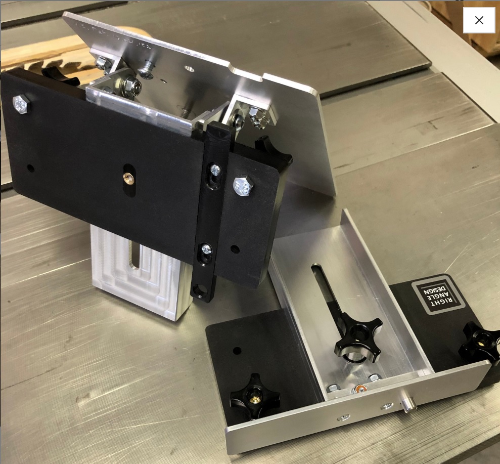

It looks like someone has replicated the Festool crosscut functionality using standard 25 series aluminum extrusions and a product (guide rail pivot) from a company called Right Angle Design that allows the tracks to attach to these standard Al extrusions. If I can get this product, I will probably go this route rather than getting the Festool aluminum side rails to attach to my custom MFT top. I also like his idea of building in a sacrificial throat in the MFT top.
It is a long video series (3rd video has the guide rail pivot), but if anyone is interested, check out his MFT design below:
[youtube]https://www.youtube.com/watch?v=66BB-h344sk[/youtube]
[youtube]https://www.youtube.com/watch?v=zBJIeP8iYWM[/youtube]
[youtube]https://www.youtube.com/watch?v=w2SwfSzJEoU[/youtube]

Here is a pic of the Right Angle Design pivot for attaching tracksaw tracks to an aluminum side rail. This is the first aftermarket pivot that I have seen for tracksaw tracks. Has anyone seen another company produce something similar?
https://www.etsy.com/shop/rightangledesign/
