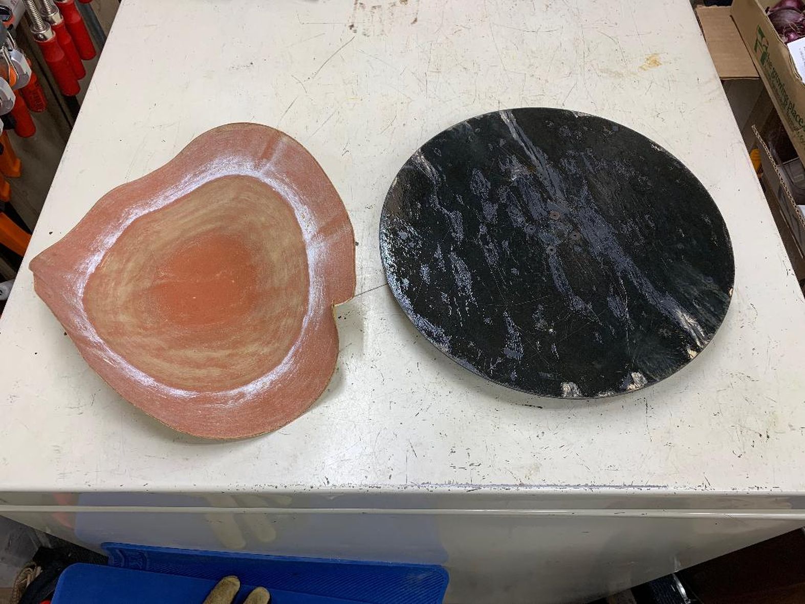

So I got around to using heat to remove a disk off a ebay 500 style sanding disk and the whole sand paper came up in one piece. There was a tear in the paper but that was there before I started. The disk had some scrapes from a previous owner and a couple of old bits of paper that were left on when the new paper was added. Just never know what you will get buying used.
Anyway it cleaned up pretty well and only took about 7 minutes which included cleaning the back side as well. It looks like the scrapes just took off the finish but didn't leave any burrs. This is my only 500 style disk I have, all the others have been converted to the 510/520 style.
Given my experience it was much more expedient to continue with what I have been doing using a little heat. My favorite is letting the disk set in the sun back side up for a while, it gets hot enough that gloves make it more comfortable to handle at that point. In the winter or rain the oven works or a heat gun on low.
If you are planning on reusing sanding sheets then heat is the only way that seems to work, if you don't care then try the cold but adhesive and residue from the paper is harder to clean up, well at least it was for me.
