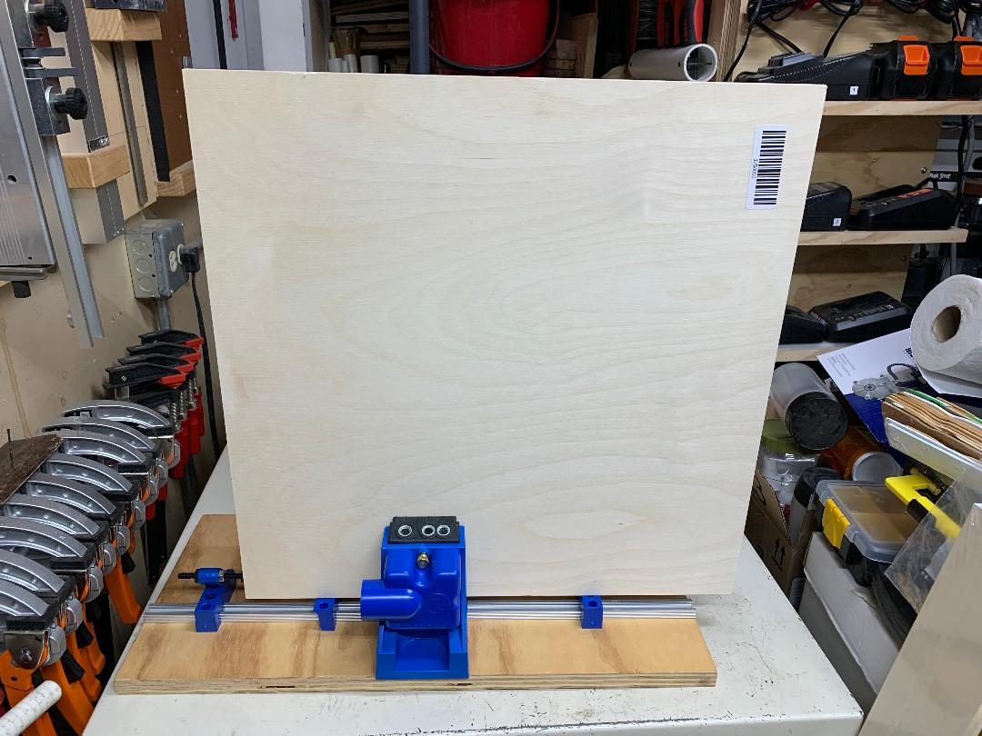

The only disadvantage of the one that I have is the lever being behind the work piece. On short parts or taller parts that aren't too long having the lever there is no issue. If however you try to do a part where you can no longer reach the lever from the front then it is an issue. In this photo it is still not a problem but if the piece were longer....
Now I mounted my jig on a plywood platform and added some mini track to both sides. Doing so allowed me to put these material support stops in place. I don't do much longer work so this size works well for me but if you were doing larger projects all the time then a longer base might be in order. These material supports make sure the holes are being drill vertical to the work piece. They also can be set up as stops to locate sets of holes the same over many work pieces. A nice addition.

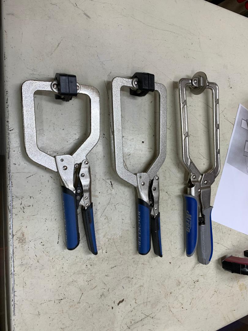

On the subject of clamps, kreg has a clamp with the label of Automaxx, I own several different versions of these and they automatically adjust for different thicknesses. You also can adjust the clamping force.
I have a mix of clamps, if it were not for the cost I'd go to all the max clamps. As a reference this is the clamp with the screw adjustment:
https://www.amazon.com/KREG-KHC-PREMIUM ... P3WWWVNHQR
It sells for about $15 and by contrast this model sells for $24:
https://www.amazon.com/KREG-KHC3-Projec ... 147&sr=8-4
When I expand my collection I like to go with the auto adjusting types but have not gone back and replaced what I have.
I find some of the long reach ones very useful on my SO vertical station and I just got a couple from Rockler for a new jig I got from them. The two to the left are the Rockler ones:
I also got on sale the Rockler Pock-it Hole Clamp® with Quick Release, only got one to try out and I haven't tried it yet. Hope to sometime this spring.
