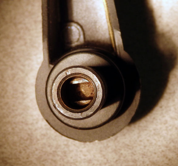

Re: Pro Planer

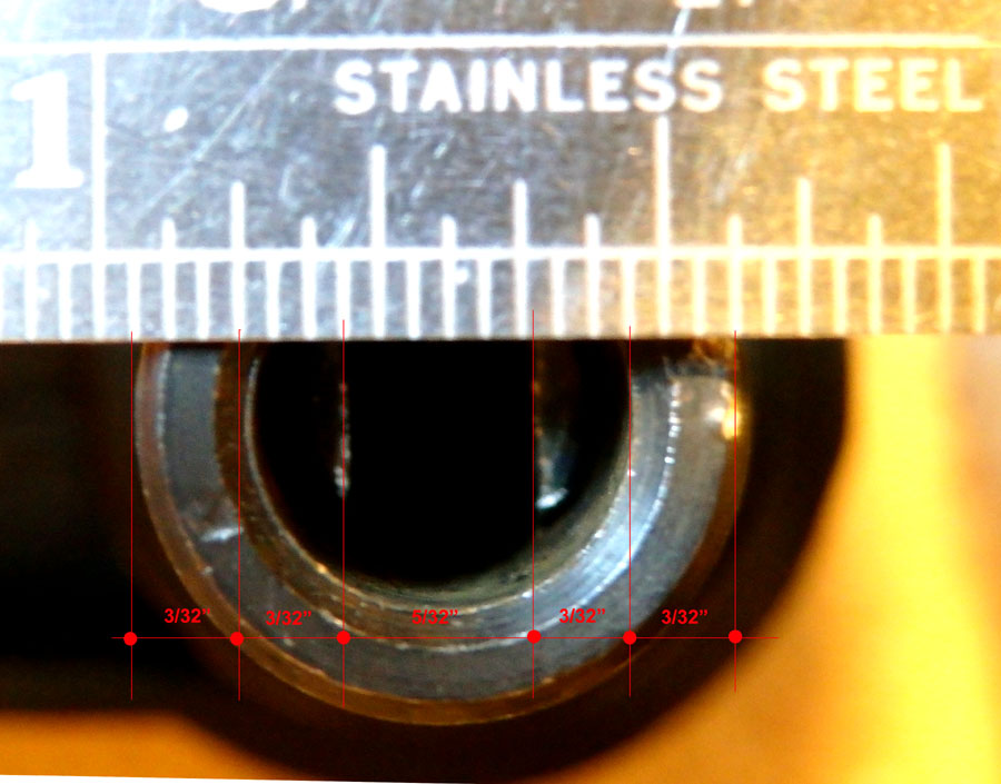

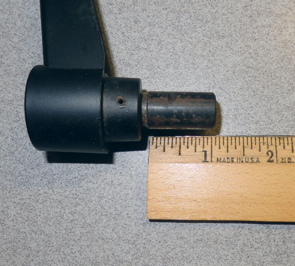

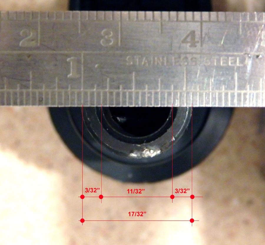

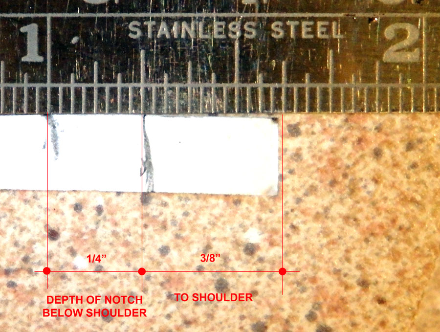

Here are some ROUGH measurements of the working end of my handle. I am going to try to make a prototype and see if it works. For measuring the depths to the "shoulders" on each side of the notch and the depth of the notch below the shoulders, I inserted a stiff piece of paper and marked the depths with a pencil and then measured the distance between the pencil marks. Meanwhile, maybe you can figure out a way to make something that will at least let you test the planer before you buy it.
- P3080576-resizedjpg.jpg (134.07 KiB) Viewed 9431 times
- P3080585-resized.jpg (124.21 KiB) Viewed 9431 times
- P3080588-resized.jpg (179.87 KiB) Viewed 9431 times
br549
- Posts: 657
Re: Pro Planer

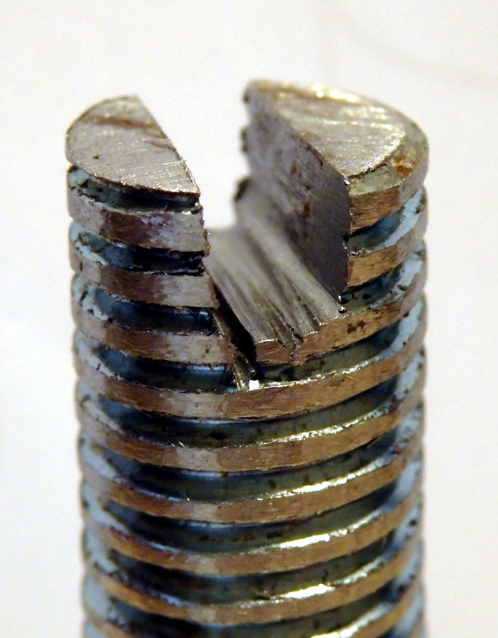

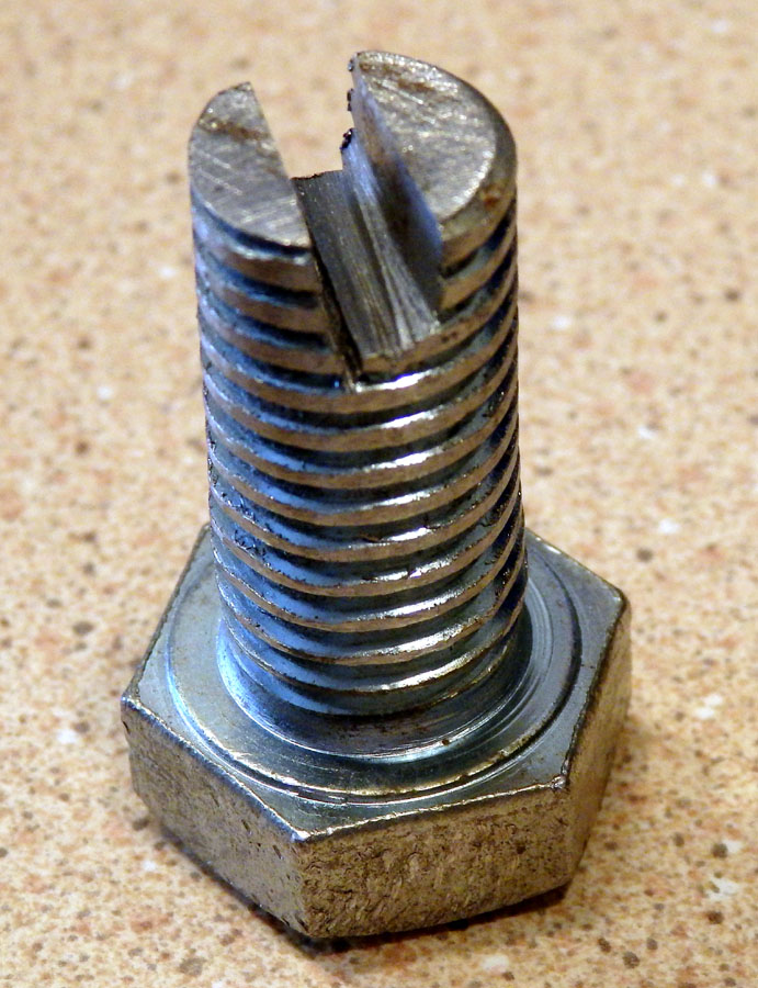

Well, it isn't pretty, but it works. I took a 5/8" dia. bolt, hacksawed a 5/32" wide x 1/4" deep slot, then filed the slot to 3/16" wide. The 5/8" diameter bolt fit inside the hole in the cover, but my slot in the bolt was not centered, so I filed down the outside of the bolt some too to compensate for the off-center slot. I had the advantage of being able to trail fit, which you won't. My final OD at the end of the bolt was about 9/16". With a 15/16" wrench or socket, you should at least be able to confirm that the table raises and lowers OK.
One more word of caution: Some planers are advertised as ProPlaners but are actually Mark V mounted versions that have been put on a power stand. The cover should say 12" Professional Planer, but since covers are easily removed and replaced, more importantly, the table should be cast iron, not a stainless steel skin over aluminum. There are also motor differences between a true ProPlaner and Mark V version mounted on a power stand. I don't recall the exact differences in motors, but you should be able to search the forum and find out.
And, if it doesn't come with an Owner's Manual, Everett Davis has scanned and made available a copy on his Google Drive. https://www.shopsmith.com/ss_forum/main ... 16113.html
- P3080591-resized.jpg (176.47 KiB) Viewed 9420 times
- P3080590-resized.jpg (132.23 KiB) Viewed 9420 times
