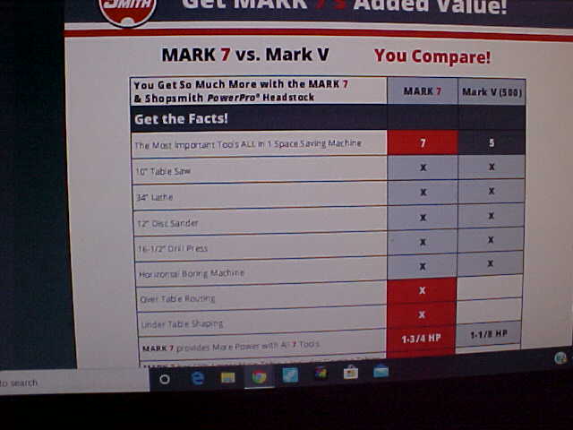

I have no Shopsmith experience but acquired a Mark V 500 and upgraded it to a Mark V 520 table system. I got several router and shaper chucks with my purchase. I presumed that the Mark V was capable of router operations because my purchase included router chucks and router bits. After looking at a comparison of the Mark V and Mark 7 on the Shopsmith website, I am confused. It doesn't reflect that router operations can be carried out using the Mark V. Please explain and thanks in advance.

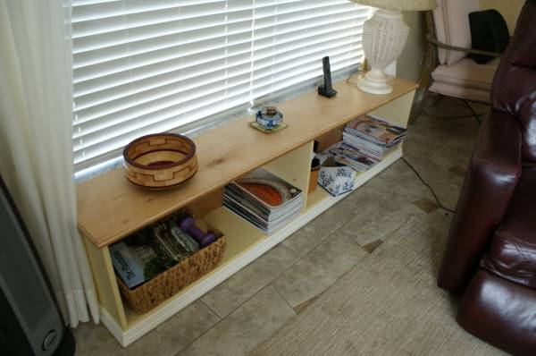

I have only used the router function on the mark 7 one time to put some slots in some cabinet shelves to prevent the shelves from shifting. The slots were 3/8 inch wide and about half the thickness of the shelves deep. some 1/4 inch dowels were installed in the uprights of the cabinet so the dowels are in the slots when the shelves are used. I had no problems with the operation and was pleasantly surprised at the smoothness of the cuts.
Here is a pic of the cabinet.
Bill V

I purchased the Powerpro headstock, so speed will not be an issue. I really appreciate the responses. I was just confused because of the comparison chart which didn't reflect routing capability with the Mark V.

I believe the comparison chart you saw only lists the main 5 functions of the Mark V vs. the main 7 functions of the Mark 7. These are what they come able to do without buying additional accessories when they come from the factory. As an example the Mark 7 comes with some routing and shaping accessories that the Mark V 520 does not. See the Mark 7 standard accessories at this link. Note items 16 to 19. https://www.shopsmith.com/markvsite/standardaccess.htm Also the Mark 7 with the double tilt feature can do under table routing and shaping. To do under table routing and shaping on a Mark V requires the Speed Increaser. The two main differences between the Mark V 520 and the Mark 7 is the double tilt and the standard headstock vs. the Power Pro headstock with a wider speed range. Adding accessories allows both to do way more than their 5 or 7 main functions. Even out of the box there are still accessories needed to do their main functions. Neither comes with lathe chisels or drill bits. They are extra.
