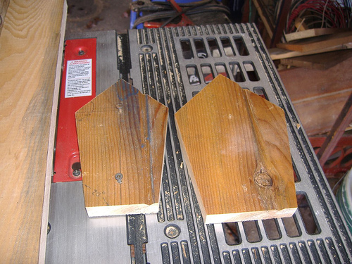

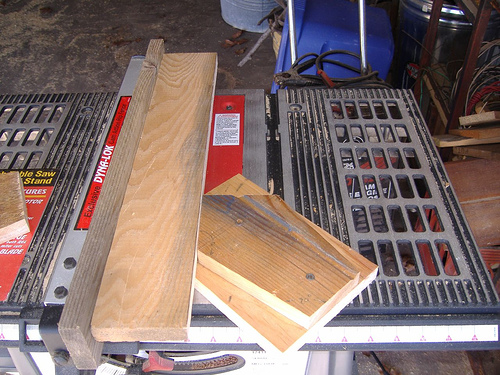

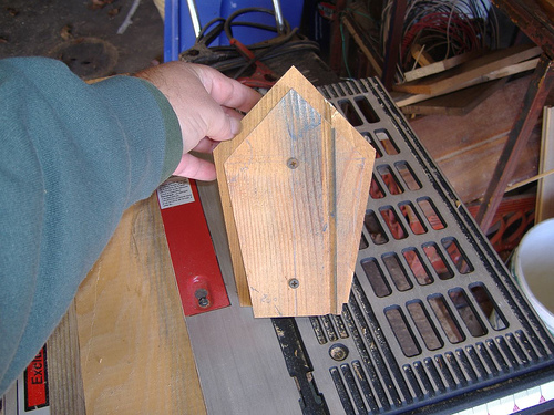

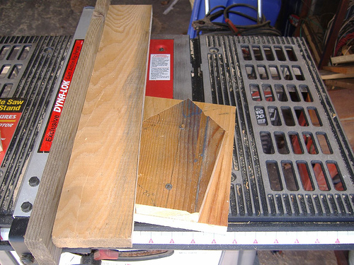

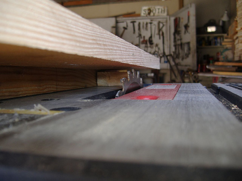

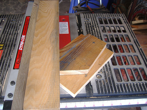

This is one of the mysteries of life... I was sure I posted this here before but my searching doesn't find it. I see Nick later did a Saturday morning segment on this but I haven't watched. I was about to make the Flickr photos go away when I decided I'd post them here... some people with out high speed connections might find them useful.
You will notice that the saw is not a shopsmith but that matters little. This is from when I got to teach my older brother how to do this. He makes hundreds of birdhouses every year... and I mean like 800 to 1000. It is all done with scrap wood and sold dirt cheap in his yard. People stop by pick out what they want and put the money in a little metal box on the honor system.
The pictures are clear enough as to how it all works but if you have questions ask away.

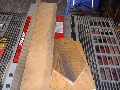

A couple of notes here. The pattern was made so the hole made by the top screw also locates the bird house entry way... and this is the inside so on the back the screw holes are inside out of sight.
On this one I think I use a 3/4" offset but it might have been 1" and the bottom wasn't cut but it could have been had my brother not already cut these pieces to length.
