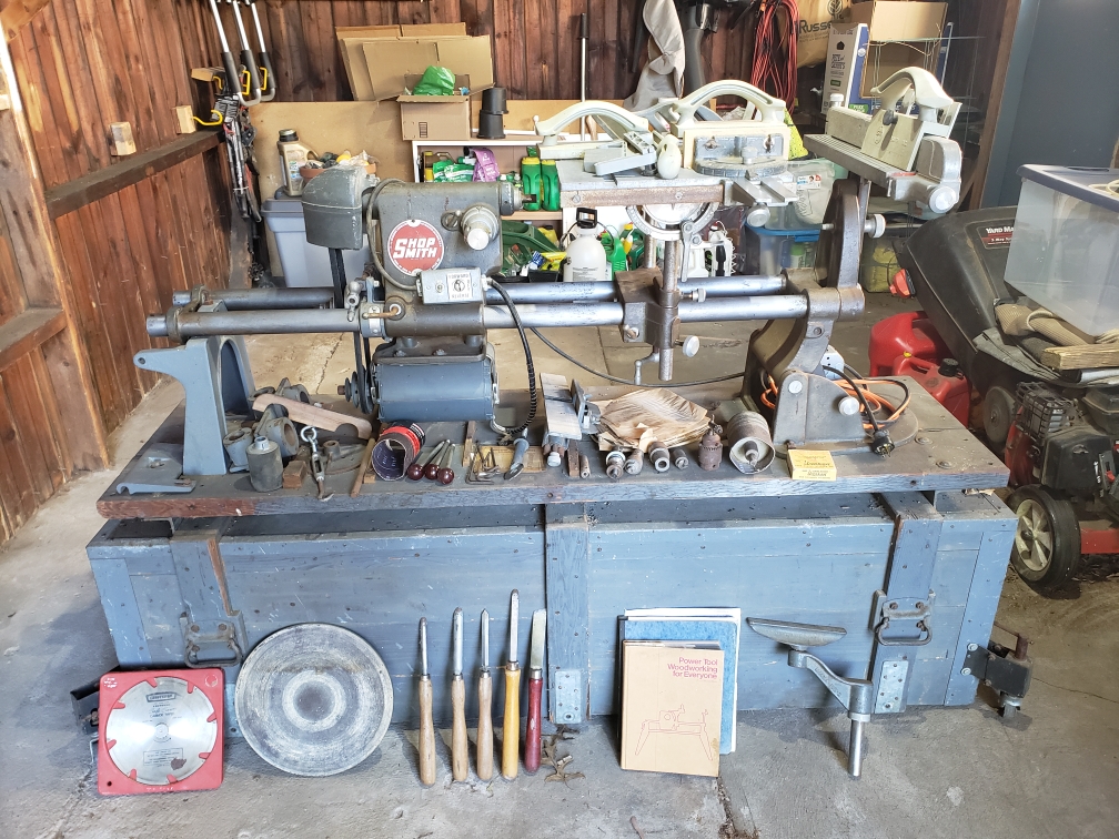

I have a model 10ER for which I need to find a new, hopefully happy, home. The machine was my father's (S/N ER-10822, possibly built in 1949) - he maintained it and used it for many years, refusing to replace it with a Mark V. I purchased a Mark V from a neighbor some years ago, PLUS we'll be moving (away from the Boston area) sometime next year, and moving this machine would be silly.
Here's the machine:
Everything sitting on or in front of the machine comes with it. The blue binder contains the ORIGINAL Owner's Guide, various accessory brochures, and even several issues of the "Shop Notes" newsletter.
I've cleaned up and waxed the ways, and cleaned the drill chuck. I've also plugged it in and run the motor to make sure that still works.
What you can't see in the photo is that the machine is equipped with the two-belt variable speed changer (where the positions of the belts determines the range, and a crank adjusts speed within the range).
The base is a home-built shipping container for the machine, with swiveling casters on the corners.
My question: where is the best place to advertise the machine for sale - what audience would best understand what it is?
I could post to CraigsList, but have no idea whether that would reach the right audience. (I have a deep aversion to eBay.)
Of course, if anyone on this forum would be interested in the machine (with all the attachments and accessories shown), that would be good too.
