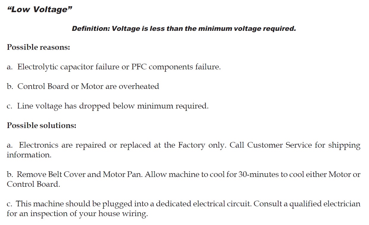

This thread (https://www.shopsmith.com/ss_forum/view ... ow#p266679)may have some answers for you. Also, have you seen the troubleshooting document from Shopsmith (see below):
MARK_7_Troubleshooting.pdf
(58.29 KiB) Downloaded 793 times

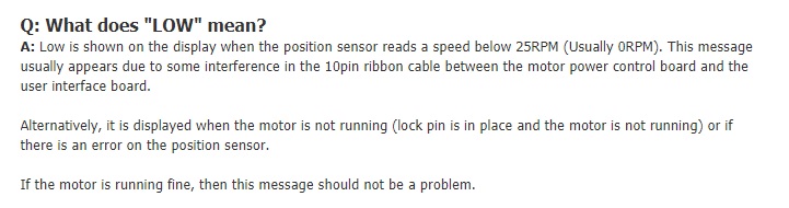

Don't know if this is of any use, but I found this on Teknatool's website related to their DVR motors (Teknatool makes the PowerPro components for Shopsmith). Perhaps this "LOW!" warning/error message is the same between Teknatool Striatech's DVR offerings and the PowerPro. It might be worth double-checking the connections between the PowerPro components. It could also be a problem with the position sensor, so possibly dust infiltration is causing it?
https://teknatool.freshdesk.com/support ... technology
📶RF Guy

If the definition for "LOW!" provided by RFGuy from teknatool is right, then it may not be telling you anything that you don't already know: that the unit shut down. I suggest taking video of the screen when the fault occurs to go back later and see if there is a fault indication at the time it starts shutting down.

The issue here is why the machine is shutting down. When the machine "shuts down" or turned off you always get a LOWVOLTAGE "error" on the screen. That is not a true error condition. If you get a LOWVOLTAGE error with the machine running then that is a problem as addressed in the troubleshooting section of the manual. There is no LOW error in the manual, only LOWVOLTAGE.
