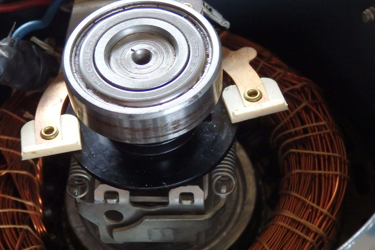

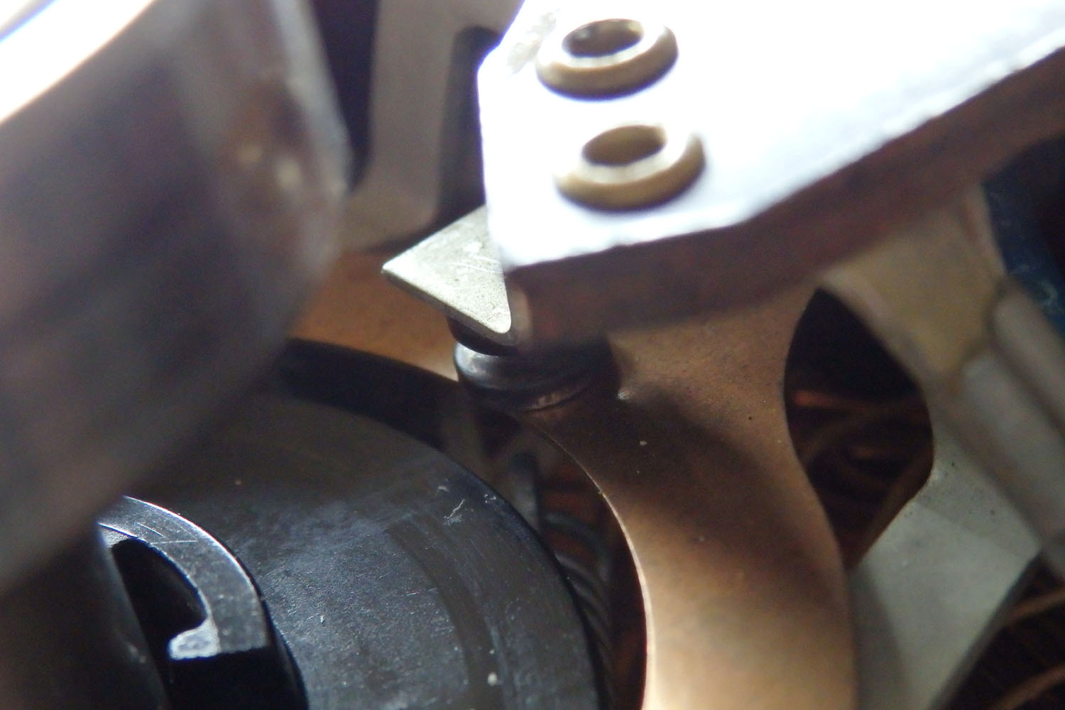

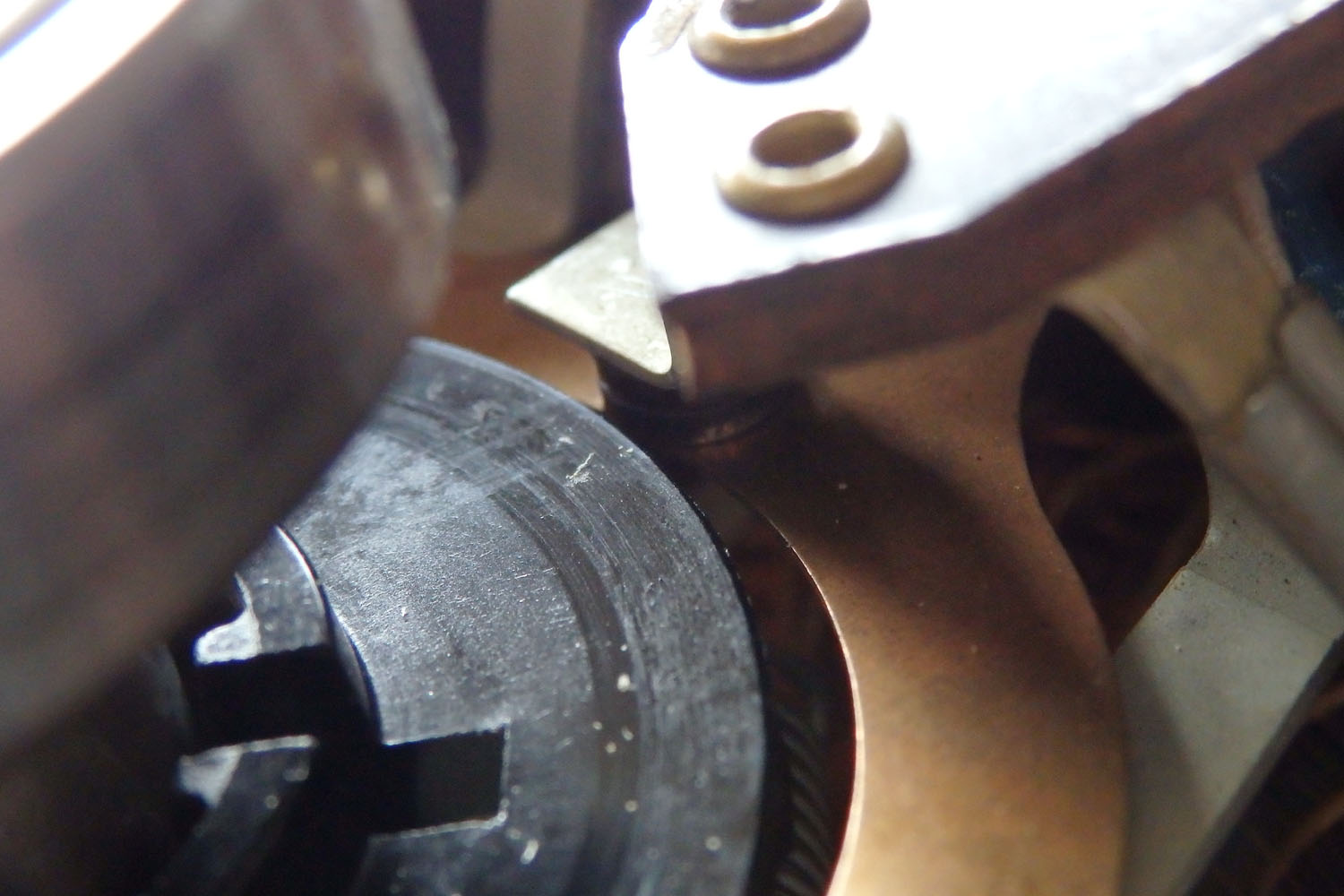

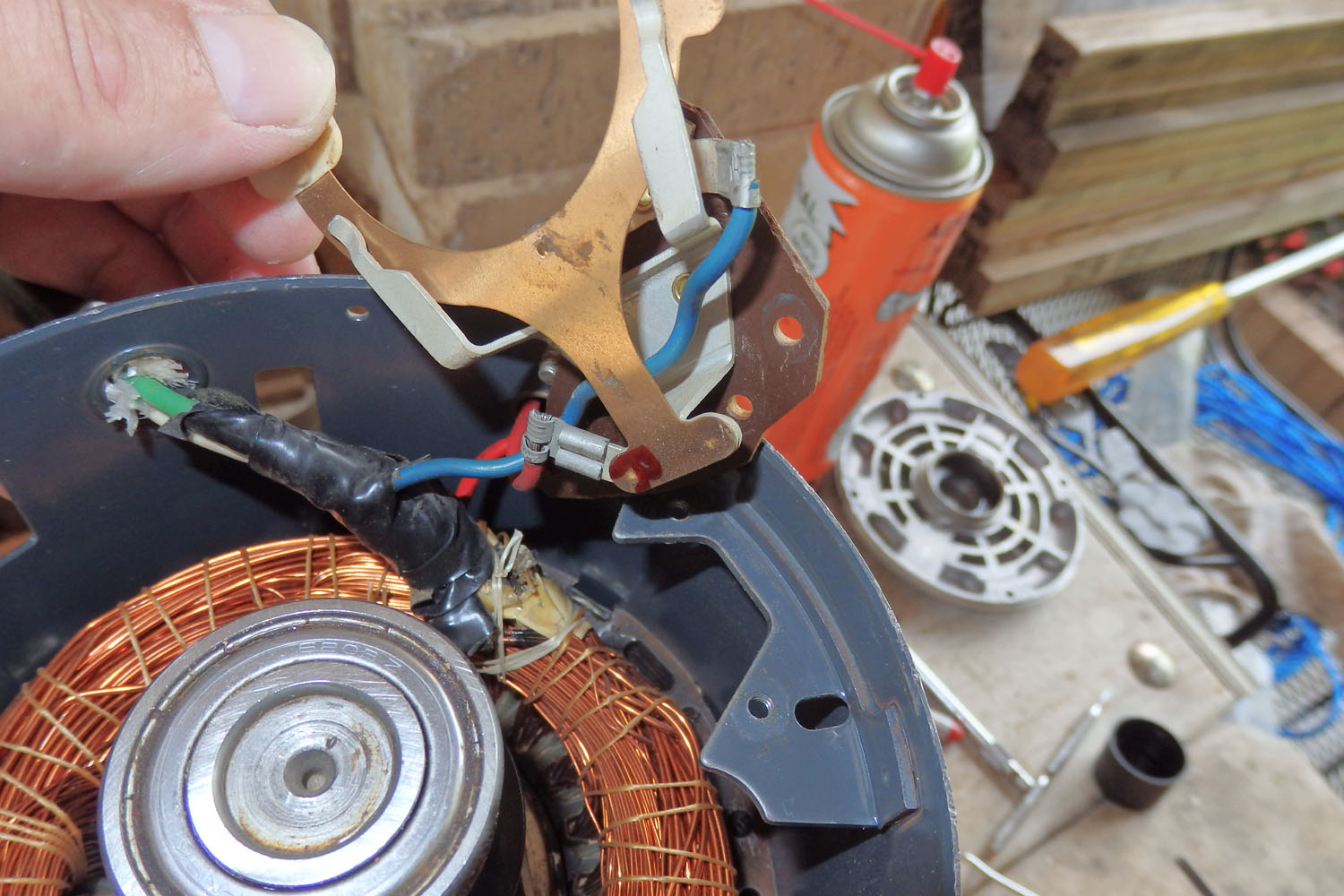

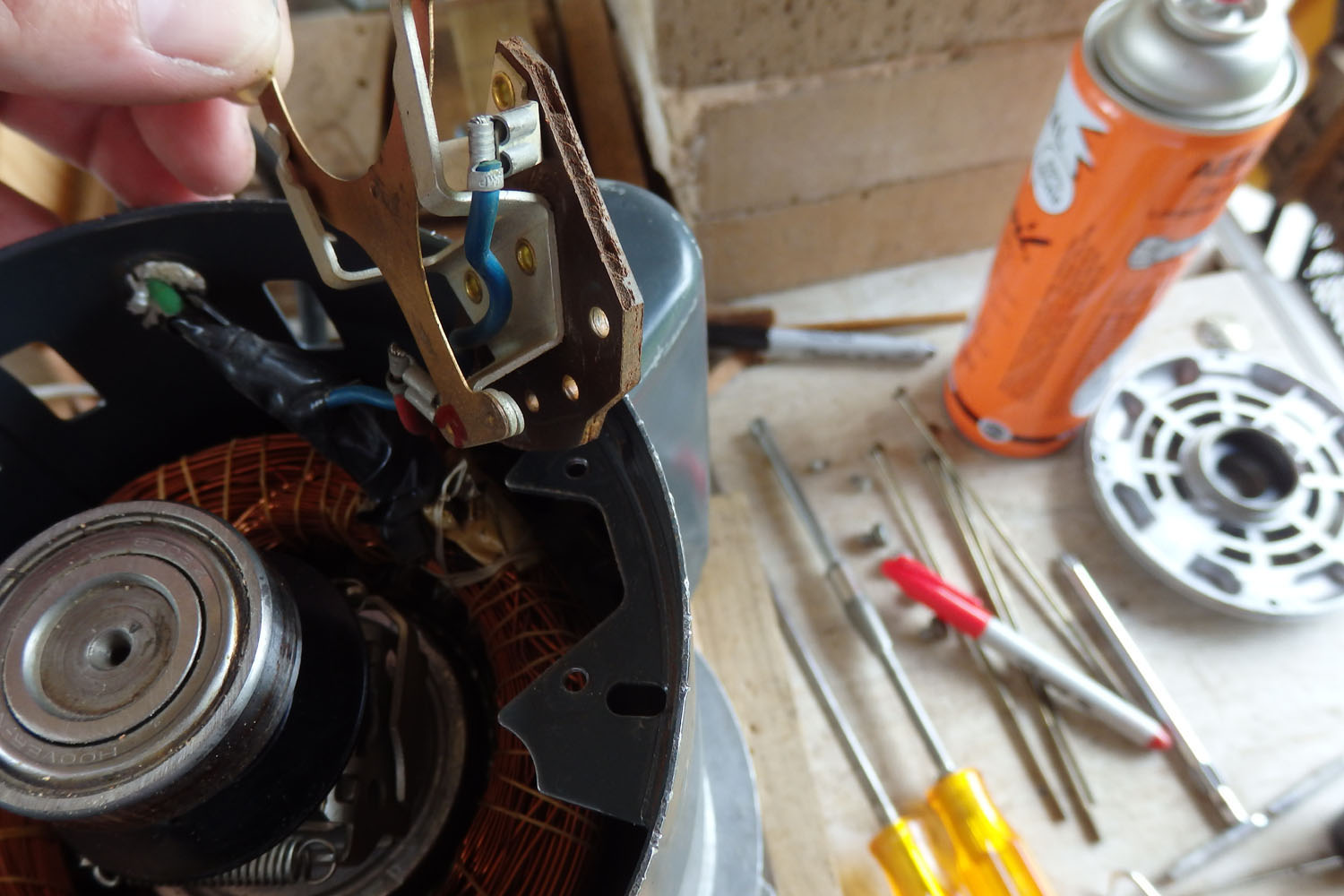

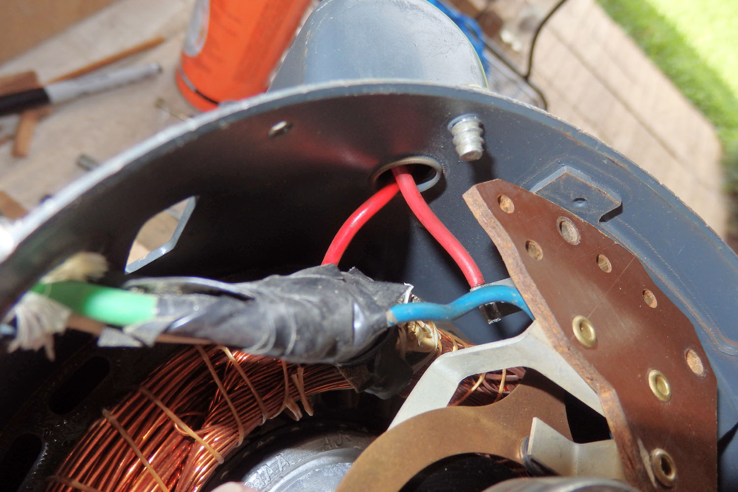

The start contacts are internal to the motor. There are different versions of the 1-1/8 hp motor, but here is what my GE start switch looks like. Fairly easy to get to after removing the end cap on the motor Just take your time and take pictures along the way if any doubt as to how it should go back together.
Here is a link to a thread about the GE start switch, and helpful advice I received from others.
