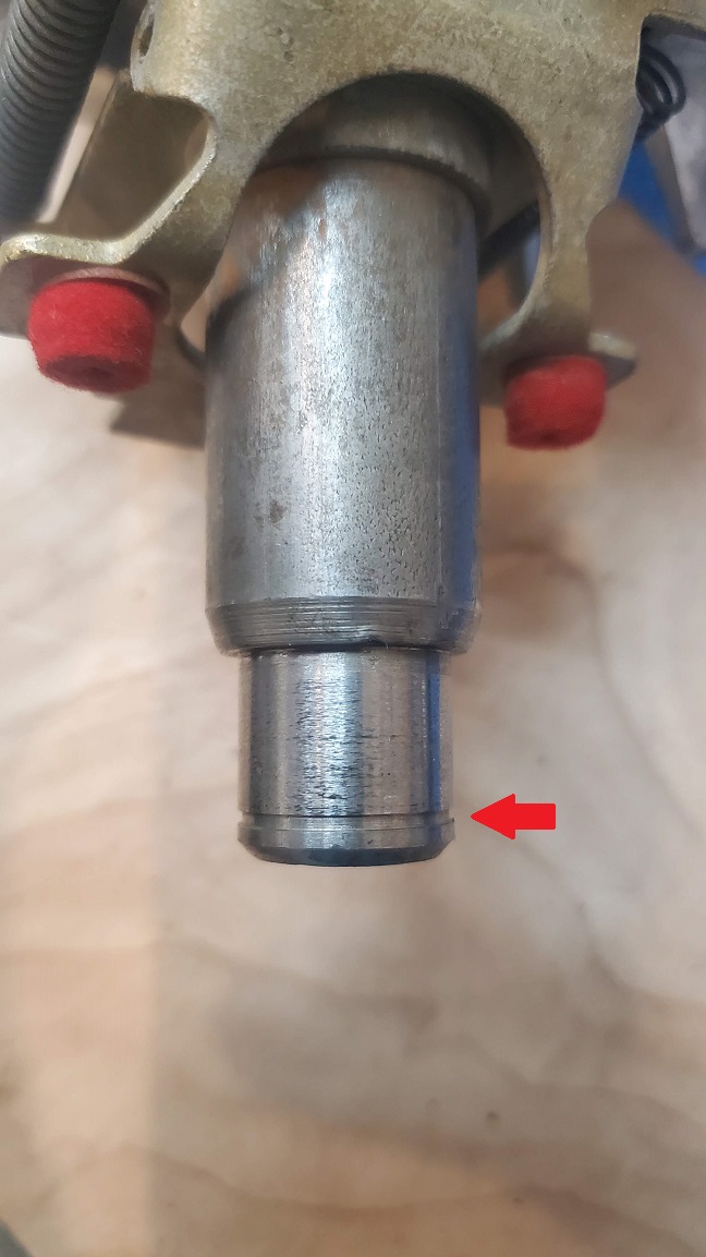

Motor update - After all that research I ended up ordering replacement bearings from Grainger. Here is what I ordered based on my research.
https://www.grainger.com/product/SKF-Ra ... ing-23Y205?
Does any have a photo of the motor shaft with the bearings? or know if the bottom (short end of the shaft) bearing needs a snap ring? I noticed there is a groove viable when the bearing is installed where a snap ring could be installed. Guessing it doesn't need one-would make the disassembly difficult.

The bearings are a slip fit not pressed in for the A. O. Smith Motors. I don't recall a snap ring on the shaft end of the 3/4 HP Motor I did last. I didn't take any pictures of it while I had it apart. I would have to take apart the other one I have waiting to be worked on to check but it will be a while until I get to that one. The one I did last is on a 10ER waiting to be sold. The only thing a snap ring would do is keep the bearing on the shaft when taking apart the motor. Otherwise the bearing would stay with the part, shaft or housing end, having the most friction. Operationally I don't think it matters.

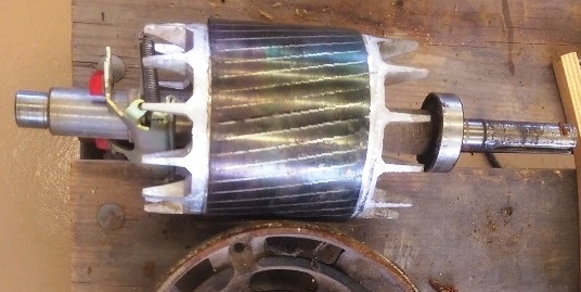

The 1/2HP motor has no grove in the end of the shaft.

looks suspiciously like a groove.jsburger wrote:The 1/2HP motor has no grove in the end of the shaft.
Re: Craigslist find = New project 10ER
Look again at the OP's post and picture. He is talking about the other end of the rotor. The end that goes in the closed end bell where the centrifugal switch is.JPG wrote:looks suspiciously like a groove.jsburger wrote:The 1/2HP motor has no grove in the end of the shaft.
Correct, thanks for the picture!jsburger wrote:Look again at the OP's post and picture. He is talking about the other end of the rotor. The end that goes in the closed end bell where the centrifugal switch is.JPG wrote:looks suspiciously like a groove.jsburger wrote:The 1/2HP motor has no grove in the end of the shaft.
