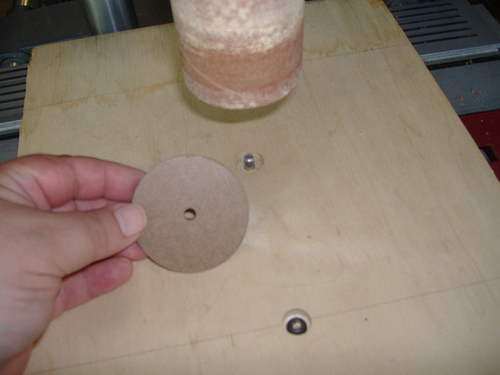

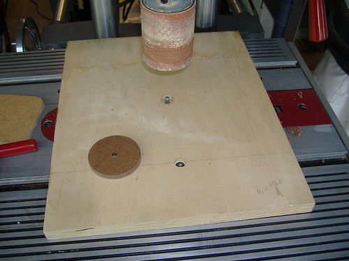

Platform that centers over center line of shopsmiths main shaft. Used for any number of operations.

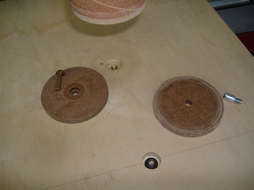

Shown is 1/4" pin and disk with 1/4" hole and same outside dia. as sanding drum.
[ATTACH]2807[/ATTACH]
Disk is put on pin, if you don't want it to turn then use some double side tape to keep it in place. Other wise it turns with the template.
Warning if you are going the wrong direction you might un thread the pin after a while.
[ATTACH]2808[/ATTACH]

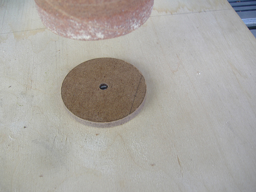

Disk is in place and ready to use.
[ATTACH]2809[/ATTACH]
Note that drum sander is lowered so it just clears the disk.
[ATTACH]2810[/ATTACH]

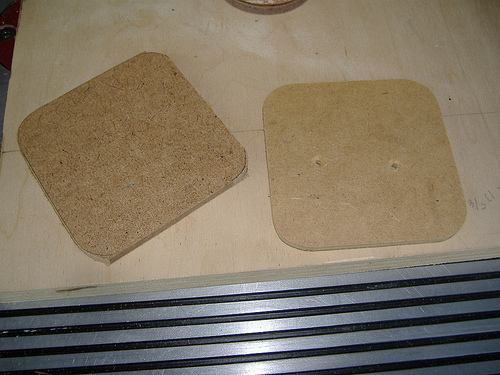

didn't have a project to do at this moment using this but I wanted to present it anyway as maybe someone else is working on something that this idea would help. What I did was take a cut out from another project and made it into a pattern... so if you are wondering what you are seeing it is really nothing but a prop for this posting.
On the right is the pattern, on the left is a piece I cut out on the band saw leaving the line plus a bit... If you leave to much it is more work to do this operation so keep it close.

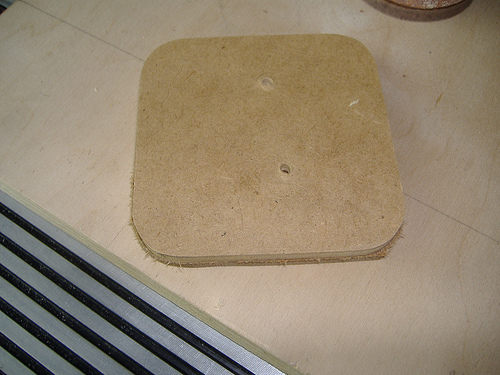

Pattern and new piece are stuck together with double side tape.

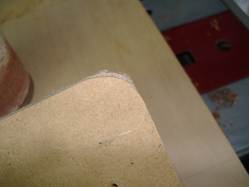

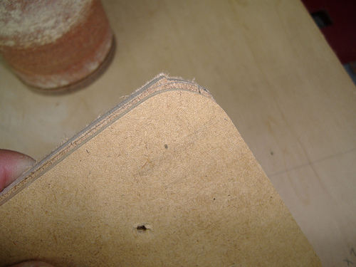

You can see that the corners were not close at all...
[ATTACH]2813[/ATTACH]
Another of the corners, maybe just a little better then the first.
[ATTACH]2814[/ATTACH]

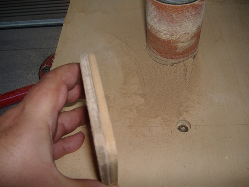

The stack is then sanded. Keep the pattern on the bottom against the pin and the workpiece on top where the sanding is happening.
Note the pile of sawdust. That is what it took to get the pieces to be the same... I guess I should have added a dust port... maybe next time.
[ATTACH]2815[/ATTACH]

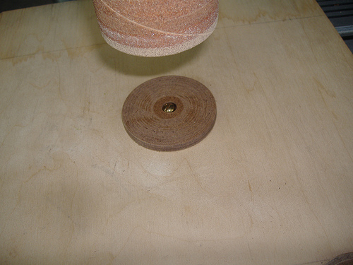

I also have a disk that uses a 10-32 screw to mount the disk. I was trying out both methods and I still can't decide any advantages or lack of them for either method.
[ATTACH]2816[/ATTACH]
Disk in place. If you look close you might have noticed the head is above the disk height, that is only because I didn't screw it all the way in.
[ATTACH]2817[/ATTACH]
