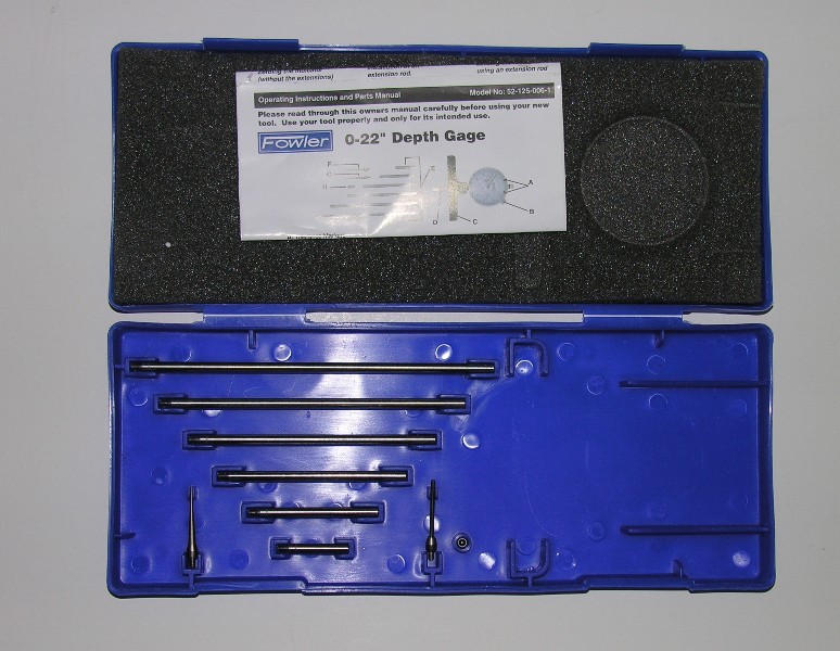

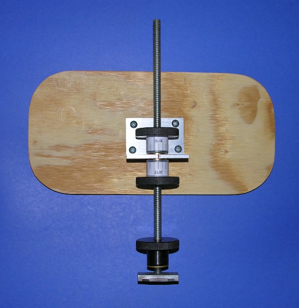

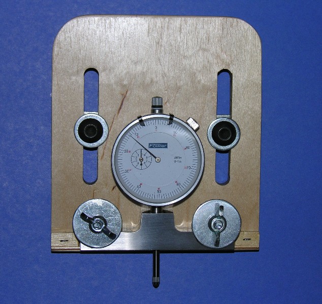

Fence Adjuster
Dusty,
This is what I came up with for moving the 520 fence in and out and a method of measuring the movement from 0-22 inches in thousands. I just zero the depth gage to the blade and add the extensions for the measurement needed. Seems to work quite well and if there is enough interest I will post some pics of it on the SS.
ldh
[ATTACH]2789[/ATTACH]
[ATTACH]2791[/ATTACH]
[ATTACH]2792[/ATTACH]
ldh

This looks as though it will do a fantastic job of getting the required accuracy dialed into your cuts.
I have a question though. When adjusting the rip fence to the blade (width of a cut), is the dial gauge attached to the top of the fence.
BTW That depth gauge is terrific. All of those screw on extensions gives you some versatility (reach) that I cannot get with mine. This limitation is occasionally a factor.
I have not yet gotten my dial gauge attached to the fixture I developed. I need to drill and tap some holes in the base and the table saw has had priority in setup lately. I'll get mine done as soon as I can change to drill press and post a couple pictures.

Is there any sort of secret associated with the measuring tape I see wrapped around the adjustment screw? Is that home made?

Dusty,dusty wrote:This looks as though it will do a fantastic job of getting the required accuracy dialed into your cuts.
These are great ideas. Hopefully someone else will find a hint that works for them and develop one of their own. Each new attempt usually results in some improvement.
The knobs that you are using now look to be a perfect fit for this application.
It can be mounted on the fence or in the mitre slot, your preference. The steel knobs are 2" from the J. Winco Co. I found the steel against a brass washer on each side of the aluminum angle gave me the best results. The measuring tape is a paper scale attached with #77 adhesive that I made with a cad prg on my computer. The small tics are 1/16 of 1/16 inch movement of the fence or about .004. Clear scotch tape around the paper and they are fairly durable....and cheap to replace. I am now working on a 8" indexing wheel the will atach to the back of my Oneway chuck.

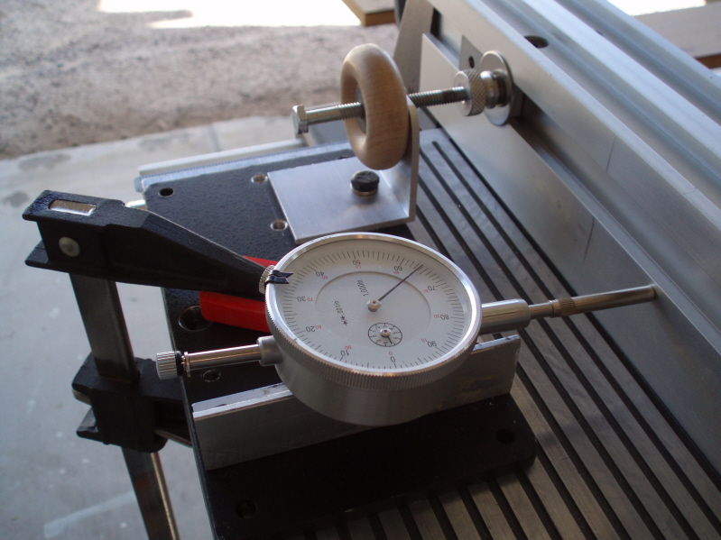

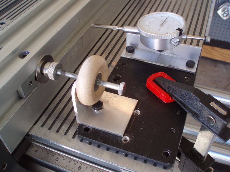

My version of the Micro Adjuster is now complete except for some sanding and a paint job.
I decided that I didn't need the indexing tape (at least for now).
The major problem with the previous version was that I could hardly turn the know (too small). I fixed that by modifying a wooden wheel that I had in my scrap box.
I attached the dial gauge mostly to be able to measure the movement during development. The dial gauge will probably not be a permanent attachment.
These photos show the jig attached to the Mark V with a clamp. The jig can be outfitted with a Shopsmith T-Nut and attached to a t-track that way.
If more reach is required, the base can be turned 90 degrees. If still more reach is required, the bolt will be replaced with a piece of threaded rod. Of course the fixtures need to be relocated on the base. The base has been predrilled and tapped to facilitate that.
- Micro Adjustable Rip Fence 1.jpg (277.72 KiB) Viewed 5289 times
- Micro Adjustable Rip Fence 2.jpg (222.22 KiB) Viewed 5284 times

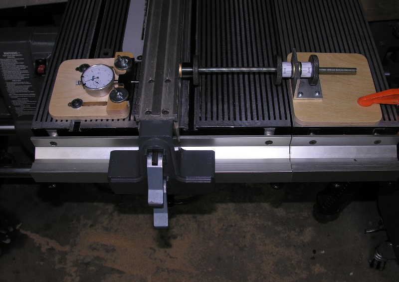

Chuck,charlese wrote: I'd love to see it on your Mark V, When you get the time.
This is what it looks like on the 520. I zero the gage to the fence with the fence at zero to the saw blade then add the number of gage extensions I need to go from 0-22 inches. The fence adjuster allows me to move the fence in or out by thousands. It does allow for very accurate initial setup. I am sure one of the Incra or Jointech fences would make more sense, but Dusty's foray into building a micro-fence-adjuster for the SS got me thinking about it and this is what I came up with.
ldh
[ATTACH]2966[/ATTACH]
- 520FenceAdj.JPG (105.32 KiB) Viewed 5303 times
