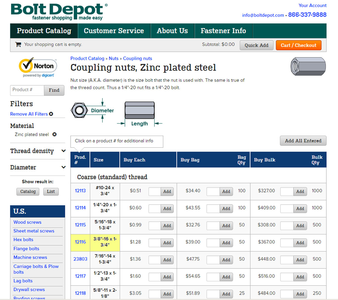

br549
- Posts: 657
Re: SS Mounted Thickness Planer clamps
The unidentified part you referred to in the Exploded Parts Diagram may be the retaining clip used to keep the threaded handle joined to the clamp body.
To make a new insert, either the female half of a sex bolt or a coupling nut might could be used and then JB Welded in place. The threads should be 3/8"-16 (NC). The coupling nut may be easier to find, as the only sex bolts I found in a quick search online were all stainless steel and $$$.
- coupling nut.jpg (247.6 KiB) Viewed 9065 times

Thanks, I ordered the coupling nuts noted. I’ll update you on how this progresses when they get in.
