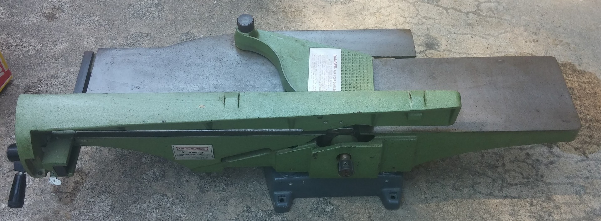

have a Central Machinery Jointer that fits on my Shopsmith. I have never had a problem with it. I have had the blades out for sharpening. They are not tapered.
It is heavy, right at 100 lbs. I had two of these and sold one.
I have never had a Shopsmith jointer and can't compare the two.

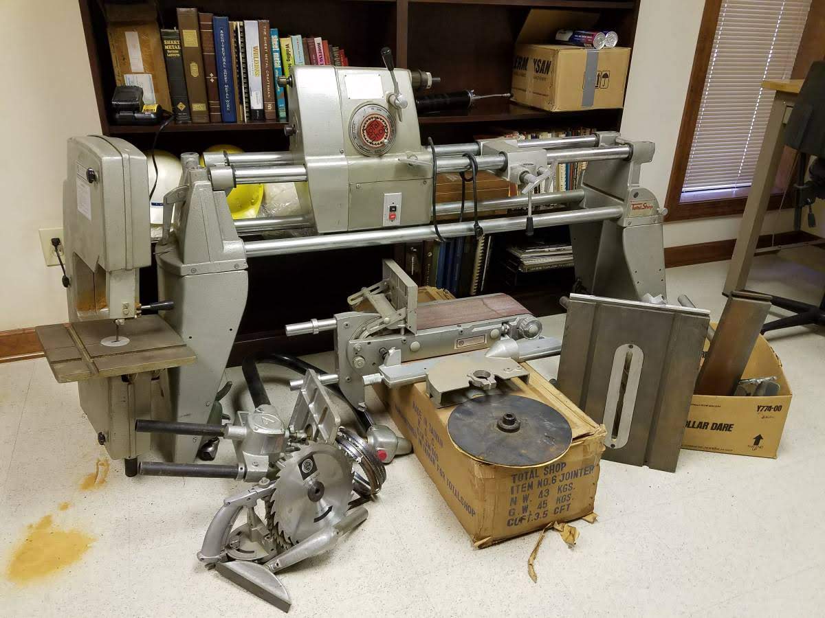

I have two of the TotalShop 6" jointers, and one is still in the box, which states a net weight of 43kg or 94.6 lbs. (See attached photo)
In my opinion it is way too heavy to add and remove from the MKV, so I would either let it live on the MKV or mount it on a dedicated stand. It's not a bad jointer, but it falls short of the Shopsmith jointer in several ways that are important to me: No feather guard, no tapered blades, no dust chute, overall lower quality casting, machining and painting.
