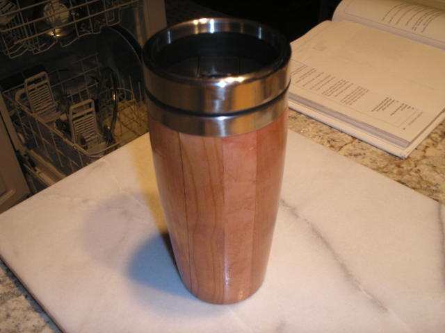

Thanks John, I gave it a try today. I don't have a Talon chuck or similar, so I used the face plate for the entire process and it seemd to work OK. I started with the live center and once it was time to part the tailstock end, I did away with the live center and finished the process with the faceplate only. One thing I learned though is that my chisels are in desperate need of sharpening!!!

Hey folks,
Thanks for keeping me busy! I mean busy on this one. I don't have dedicated bowl tools, nor a Talon or Oneway chuck, nor large Forstner bits, and I made the center plank of this scrap-wood stack from hard birdseye maple.
What I did was cut the 5 individual planks to very rough shape on the bandsaw before glue-up. Especially the center maple piece was made into a tuning-fork shape before gluing. This cut down on chiseling and hogging operations, but those were still many (into end grain).
Anyway, a real learning experience and a way to be less of a couch potato for several hours. Photo attached....

- Cranberry Coffee Mug.jpg (35.15 KiB) Viewed 2762 times

Chris,
Way to go! Looks Great! As is true with so many things, there is always another way of doing things! If it works for you....go for it!
I'm sure you are already thinking about the next One!;) Scrap wood does it again!
