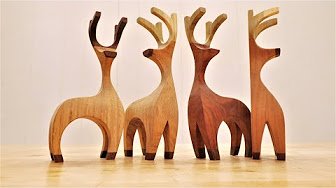

Scrapwood Reindeer
Post by Chad »
Since Scott has done so many great videos on the Shopsmith bandsaw; Nick Engler posted a great bandsaw project video earlier today. It's also posted on Nick Engler's Workshop Companion youtube channel & website thread, here on the forum, viewtopic.php?f=7&t=23891. I hope Scott doesn't mind if I post this on his thread as well. It's a quick and easy project. Just in time for the holidays. Check it out!
Watch it here: https://www.youtube.com/watch?v=W335wRy ... =11&t=123s
Get the patterns for these reindeer sculptures from our store at:
https://workshopcompanion.selz.com/item ... USYPRRQ4uE
Nick shows how to make a deer with just a few quick cuts on a band saw. It’s a handy technique called “compound cutting” and it can be used to make all sorts of three-dimensional shapes. These particular reindeer are sized so you can cut them from scraps of 2x4s. Or, glue up blocks from different species of scrapwood.
