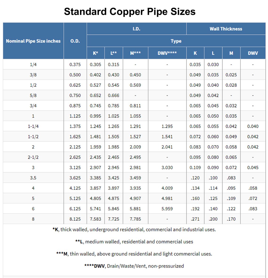

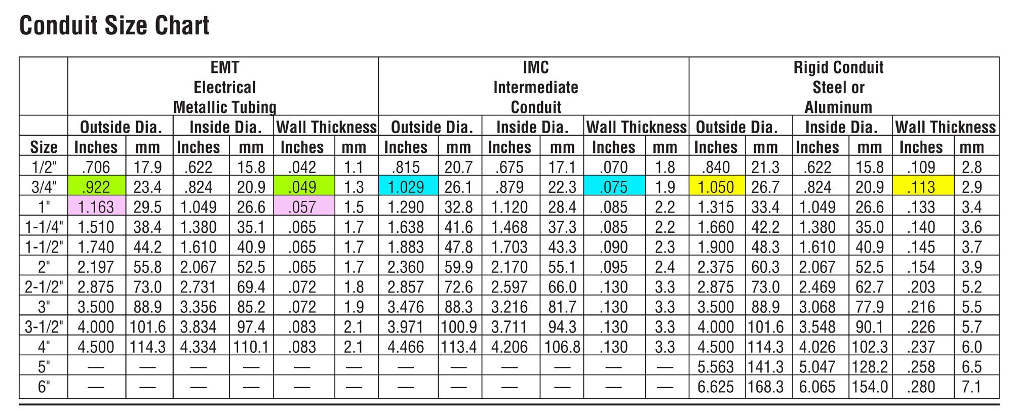

Here are a couple of charts for electrical conduit and copper pipe standard sizes with I.D., O.D., wall thickness information, in case this will help find a proper size sleeve.
For copper, also keep in mind that fittings will have an I.D. just slightly larger than the O.D. of the same nominal size pipe.
- Electrical Conduit Types, Sizes.jpg (305.17 KiB) Viewed 2063 times
- Copper Pipe Sizes.jpg (167.67 KiB) Viewed 2063 times

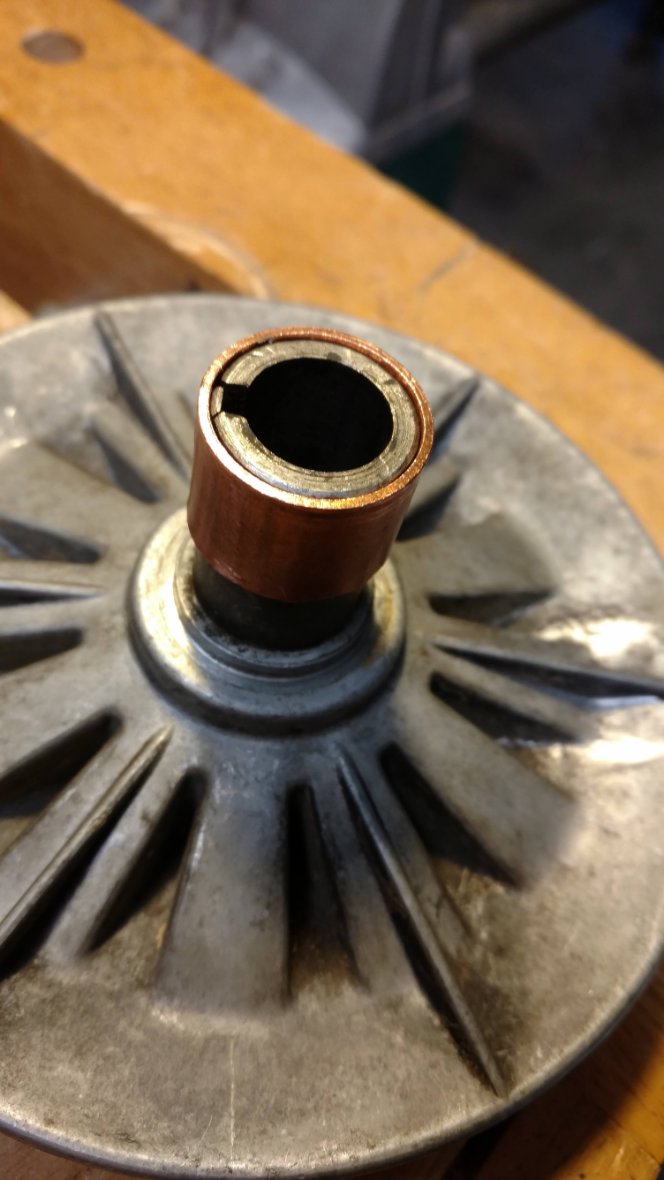

Many thanks! I just took my sheave to the hardware store and picked out a piece of plumbing tubing and cut it to length. It seems to work well, and the main spring fits over it nicely.
I got the motor housing all reassembled, and I'm astounded how well it runs now all cleaned up and lubricated. I reinstalled the sheaves with the new coller and key fits just fine. I bought a slightly oversized washer to backup my snap ring at the end of the axle, so once I rectify that I'll post a photo of the completed repairs when that's all done.
