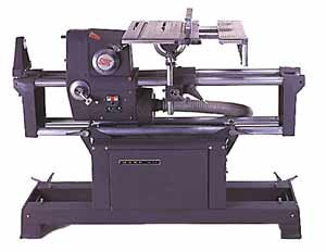

From your original post I have a question. Is your MK 7 a current MK 7 or a 60's MK VII. There is a big difference.
Just want to
Posts: 4529
Re: Will a SS Mark 7 Carriage Fit/Work on a Mark 5?

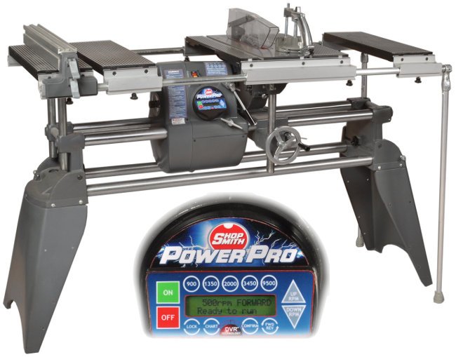

John has made a good point and I did not confirm which Mark VII or 7 you have. The first picture below is the current Mark 7. What I said above applies to it.
The picture below is the older Mark VII from the 1960's.
MARK-VII_SS Inc.jpg (10.62 KiB) Viewed 8825 times

Thanks John and Russ for the follow up, that's exactly why I was asking. Being a newbie to the Shop Smith brand and all the different models, it can be daunting ordering parts and a possible item return. I was unaware of the Mark VII model.
I have a new Mark 7 with the Power Pro headstock as shown in Russ's top picture.

chapmanruss wrote: Mon Dec 28, 2020 7:59 pm John has made a good point and I did not confirm which Mark VII or 7 you have. The first picture below is the current Mark 7. What I said above applies to it.
Russ, If I'm not mistaken, the early Mark 7/ Mark VII (It had both markings) carriage WILL fit on a Mark 5/V.
(Can't put the Mk V/5 carriage on the early Mk7/VII, because of the racks on the front way tube. (Unless you
remove the racks.)

It is best to just ignore the "Mark 7" badge on the "Mark VII".
Posts: 4529
Steve,
The Mark VII from the 1960's does have both VII and 7 on it but as JPG said it is best to ignore the 7 when referring to it. I like to add early Mark VII or 1960's Mark VII and current Mark 7 when referring to them. It does get confusing with all the Shopsmith Tools and their "Models" that have come out since their introduction in 1947. The Mark 5 was shown that way until 1980 when it changed to Mark V as listed on the tool itself. The Mark V models 500, 505, 510 & 520 refer to the table/fence system they have. The original Table/Fence system became the 500 in 1985.
To my understanding the Mark VII can use the Mark 5/V Headstock and therefor the Mark 5/V carriage with the racks removed from the way tube. JPG knows more about the Mark VII. I have seen them but never owned one to really get into it's workings.
