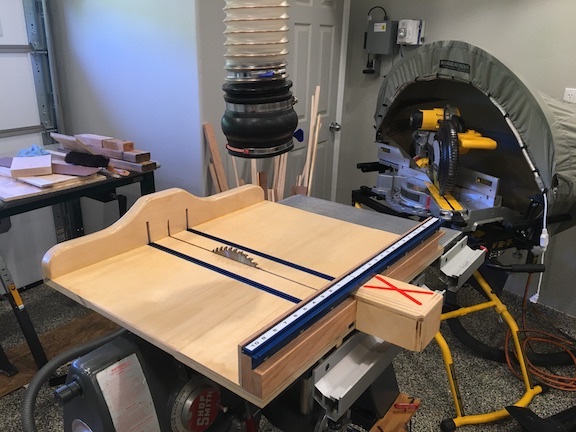

If you build a cross cut sled I can highly recommend Nick Ferry's design. You can find it on the web. I built one a couple of years ago and wonder how I ever did anything without it. If you install T-track and clamps (like Nick does) then you can safely cut small pieces too. I always reach for the sled rather than my miter gauge when doing cross cuts.
As for the accuracy, like garys and dusty said, if you build it accurately and your machine is properly aligned it will always deliver that accuracy (because the sled is linked to the miter tracks). I think you will get a lot of use out of it. The cross cut sled and tapering jig are two of my most used jigs.
