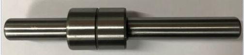

I found the answer to replacing the lower bandsaw wheel bearing. Find a #885586 Integral water pump wheel bearing on eBay or Amazon, it is the exact bearing and shaft used originally. It measures.625 shaft thickness, the bearing is 1.18 in diameter, the shaft on the wheel end is 1.75 inch and extends on the drive side 3 inches. I paid about $20. It is necessary to grind a flat on the drive end for the set screw. Otherwise you just need to heat the wheel so you can pull it from the old shaft, put the wheel on the new shaft and re install it.

Just a follow up, I installed the new bearing today “#885586 integral water pump assembly”, I heated the aluminum wheel and used my 3 arm puller, it came off smooth and easy, reheated the wheel and drove it on the new shaft to the correct depth, ground off a flat on the other end for the set screw and the saw is humming like new. Total coast was just over $20! Just make sure you get the wheel back on the shaft at the same depth as the old one so the blade lines up properly.

Is this #885586?
