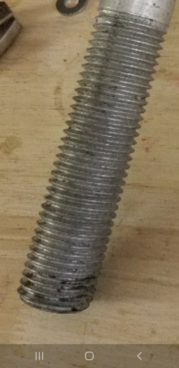

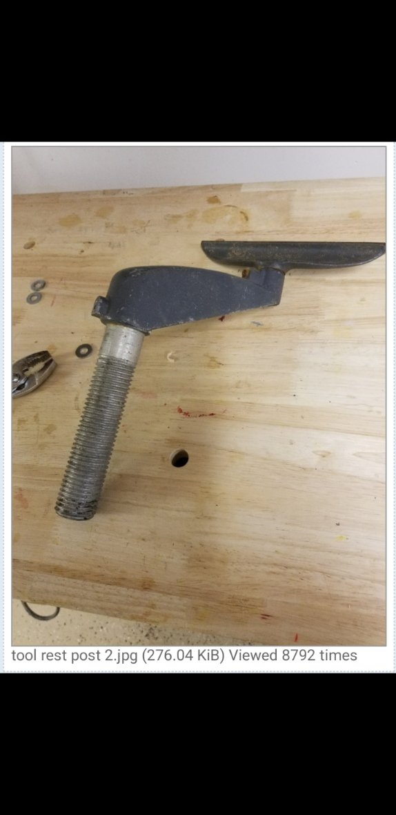

Sorry for the double reply but i forgot to type this trying to do this and listen to my wife say something and hit send lol. But by countersink I meant the groove the set screw goes in to lock it down and keep it from slipping up and down once locked. I should have said groove or step down width, you'd probably caught it right off then so thats a my bad. But yeah, to long is ok, but to short not so much lol. I wouldn't trust a leg either tho for exactly that reason to, it would work, but why risk it. I ended up cutting a 12 inch piece of 1-1/4 solid aluminum bar stock and used an 8tpi die and cut threads into all of it but the last 2 inch and turned an 1/8 deep 3/8 inch wide groove for the set screw to seat into and it works great. I found an old bed wheel/handle off an old Bridgeport mill and it just so happened to have a 5/8 hole and went right on where the lever turns it up and down so that made it easier to adjust the tool height. Moves really nice like that but it sticks out the bottom visually further than it should but ahhh, im ok with that lol. Still thinking about using this 48 inch acme thread I have and putting a worm feed on it tho hahaDLB wrote: Sun Feb 07, 2021 3:54 pm I would not want to guess how many versions of this part there have been in the 60+ years the system has been in production. Two minimum, but probably more. IMO, the rack type is better than the spiral type because 1) it locks to the carriage better, and 2) if it is not locked solidly to the carriage it won't turn very far. I measured one at 8". That is a bit longer than the spiral type I have, and which I can't measure because that design is integrated with the tool rest arm and not easily separated. If I had the equipment and was making my own, I would make it the length of a main table leg because I'd find other uses for it. (And as you point out, too long is not an issue.)

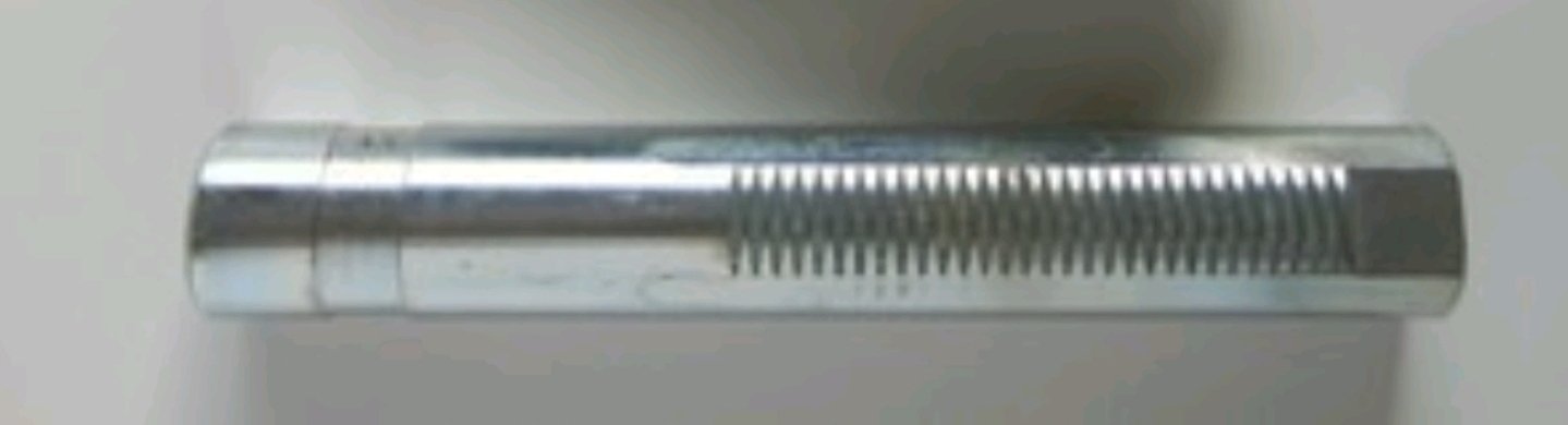

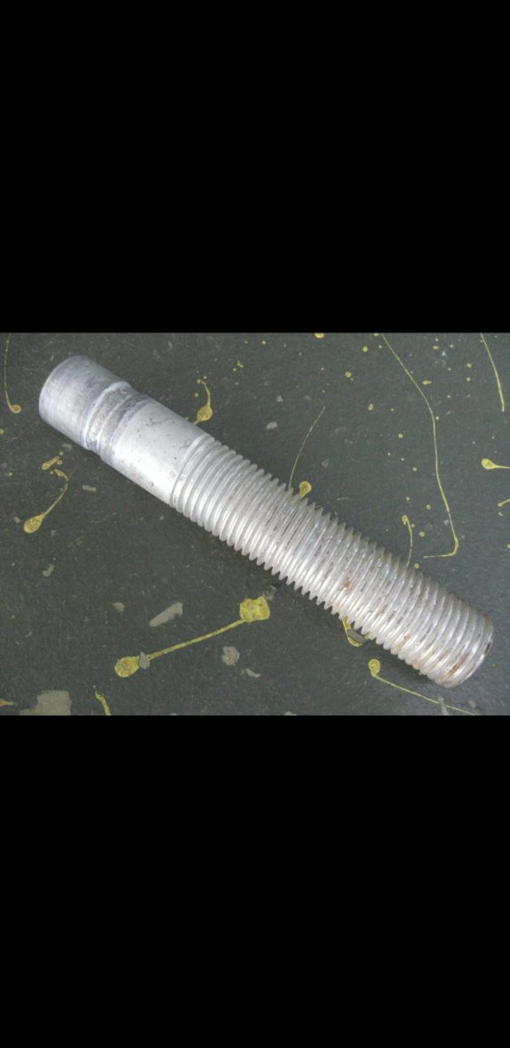

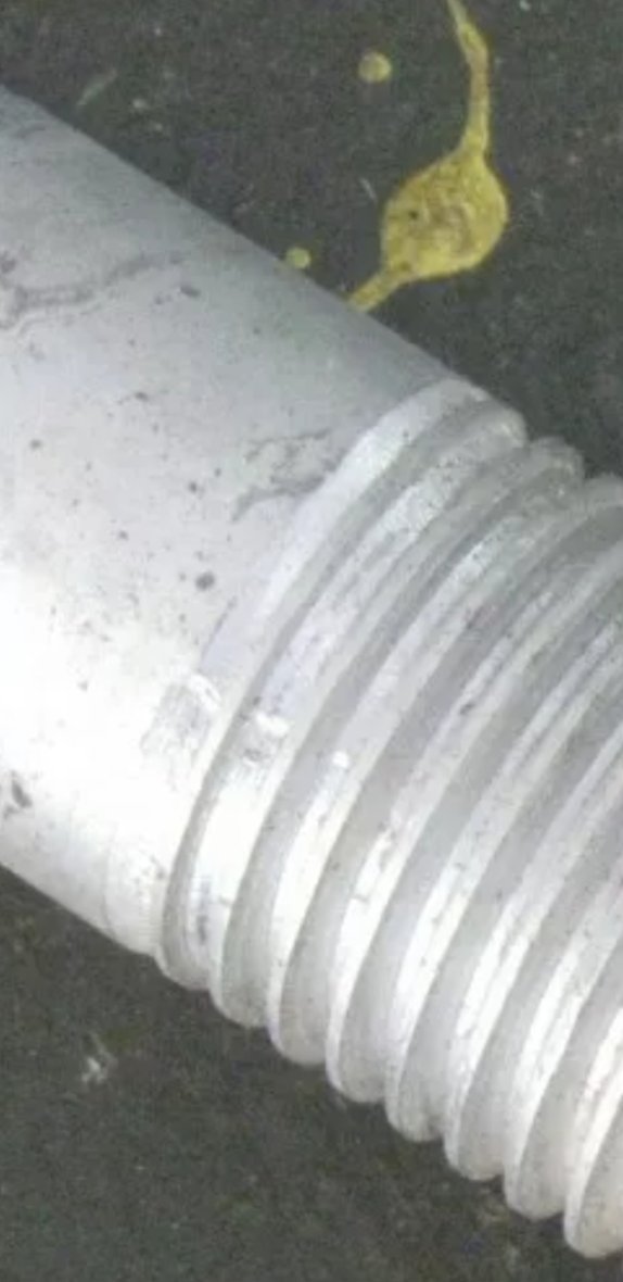

Odd then how a 1-1/4 8tpi nut* will screw right up it then I guess. Im telling you, its threaded, and this isn't the first time this has been brought up, but in others threads (no pun intended). If you pull an old style post out of the carriage of the mk5 500 model and look at it you will clearly see that its threaded. Obviously if its a newer one with the single side spline then its not, but the original mk5 500 models are definitely threaded without any doubt. Hopefully those pics i just added work cause they show the difference between the 2 different post styles between older and newer, threaded and splined.RFGuy wrote: Sun Feb 07, 2021 8:02 pmWhat??? Have you looked at the carriage the tool rest feeds into? Together they make a rack and pinion. The tool rest post is NOT threaded and a threaded post won't work in the carriage. The guys who replied to your post are very experienced and know what they are talking about so please don't summarily dismiss what they say. For help on how to post a picture please refer to the thread linked below:Burlhunter wrote: Sun Feb 07, 2021 6:48 pm The Shopsmith mk5 500 tool rest post is threaded, it doesn't have concentric rings at all. Its 1-1/4 8tpi thread. The table legs like in that one picture above is splined on one side to mimic the action of threads so it can move it up or down. But I assure you, the original factory SS mk5 500 tool rest post is threaded, mk5 520 and mk7 use the one side spline to drive it up and down tho. The logic in doing it myself is simply because I can, no more no less. Sure, I could jump on ebay right now and grab one for 20 bucks, but really, whats the fun in that? I didn't learn how to do this stuff to buy it from somewhere else, I learned it so I could do it myself lol. If I knew how to add a picture on here I'd show you a picture of one zoomed in on the last thread where you can see it tapering away and how the last couple are flat from not totally going through the die before being backed off, but thats definitely threads and not concentric rings. Nonetheless, I finely figured out how long it was anyway. saw a picture of one beside an 8 inch rest so I screenshot it and blew it up till it was the correct scale and presto, I got the measurement for the postlol.

- Finally found this one and this is what got me thinking about it.
- Screenshot_20210208-001811_Gallery.jpg (48.52 KiB) Viewed 1650 times
- This is zoomed in on the same one that subsequently made me pull out my calipers and count the threads and found out that its just a piece of 1-1/4 8tpi threaded thick wall pipe with a groove turned in it for a set screw.
- Screenshot_20210208-001750_Gallery.jpg (63.73 KiB) Viewed 1650 times
- Thats a newer version, notice that the splines are straight, perpendicular to the post where the other is slightly angled, because the first one is threaded.

- Here's another one that I screenshot from this site and its the same as the first, threaded.

- Same post as the last one just zoomed in to show a close up of the first thread.

Well it looks like I was wrong. Pretty clear from the pictures that it is a thread. Sorry.
