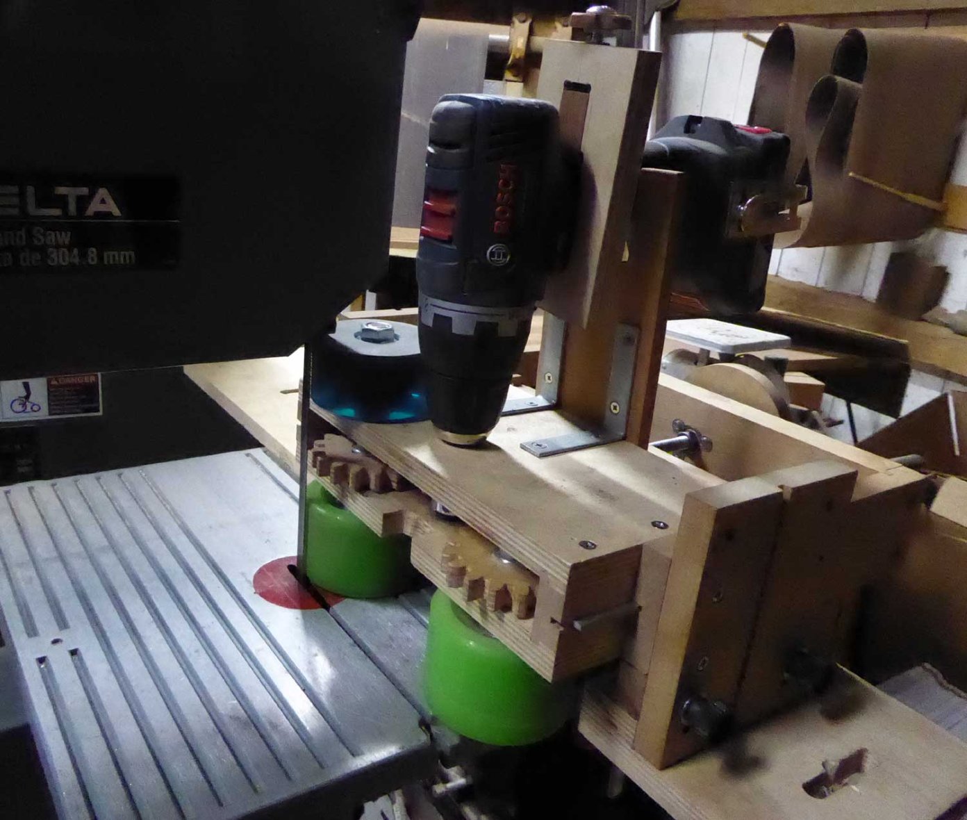

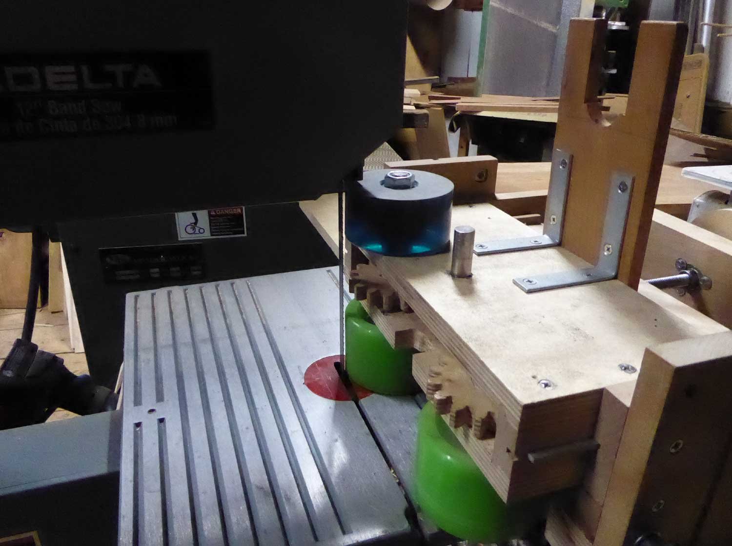

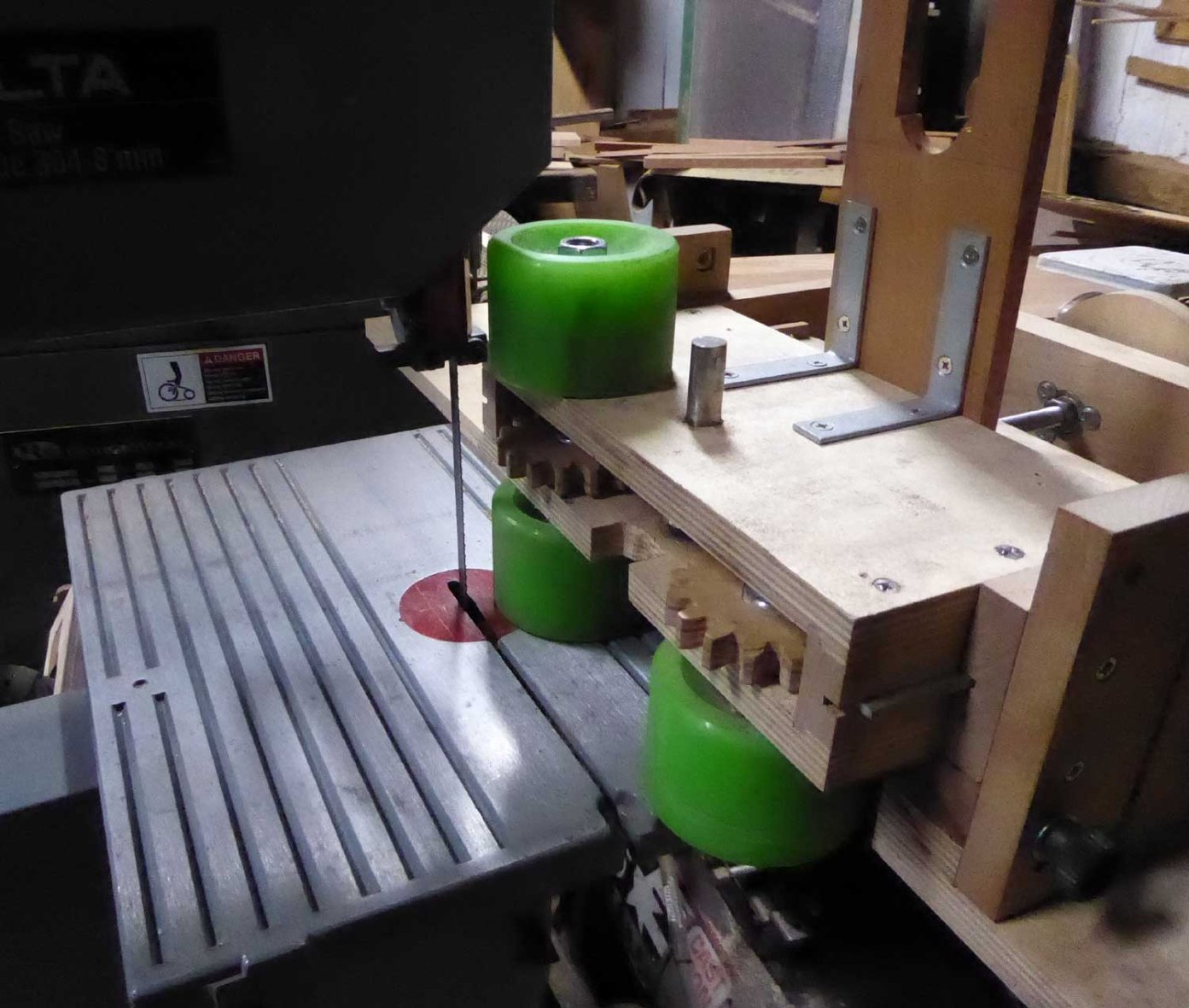

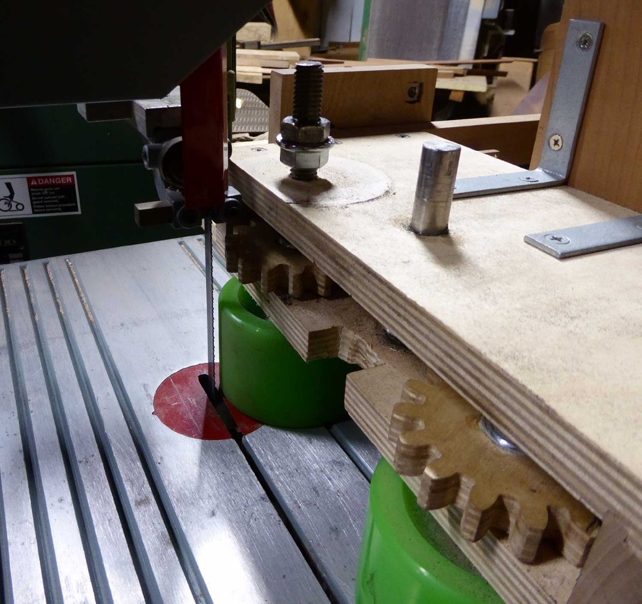

Small band saws present minor, easily solved issues. As standard construction, the Little Proteus requires 6 -5/8" or so under the guides for getting into optimal resaw position, slicing veneers. So on 6" resaw height band saws the blade guides get in the way for much of what you'd like to do. You could use it at standard construction further in front of the blade than ideal, or cutting thick stock in half with that configuration on 6" resaw height band saw.
You can just take off the upper wheel, ( a few second job) and then you've got the lower 2"high wheel doing all the work, -not a bad set up. The upper wheel only comes into play for stock thicker than 4 5/8". A better solution is to saw off some of the upper wheel, which I can do at no cost if you specify it. Then you could still take off the upper wheel for stock thinner than 4 5/8" allowing you to get the upper blade guides a bit lower, and for stock thicker than 4 5/8" you get the upper wheel pushing and feeding at the top of the board. These photos show the issues on a Delta 12" saw with 6" resaw height.
One of the advantages of the rig is it's easy to notch out or modify to configure for odd situations.

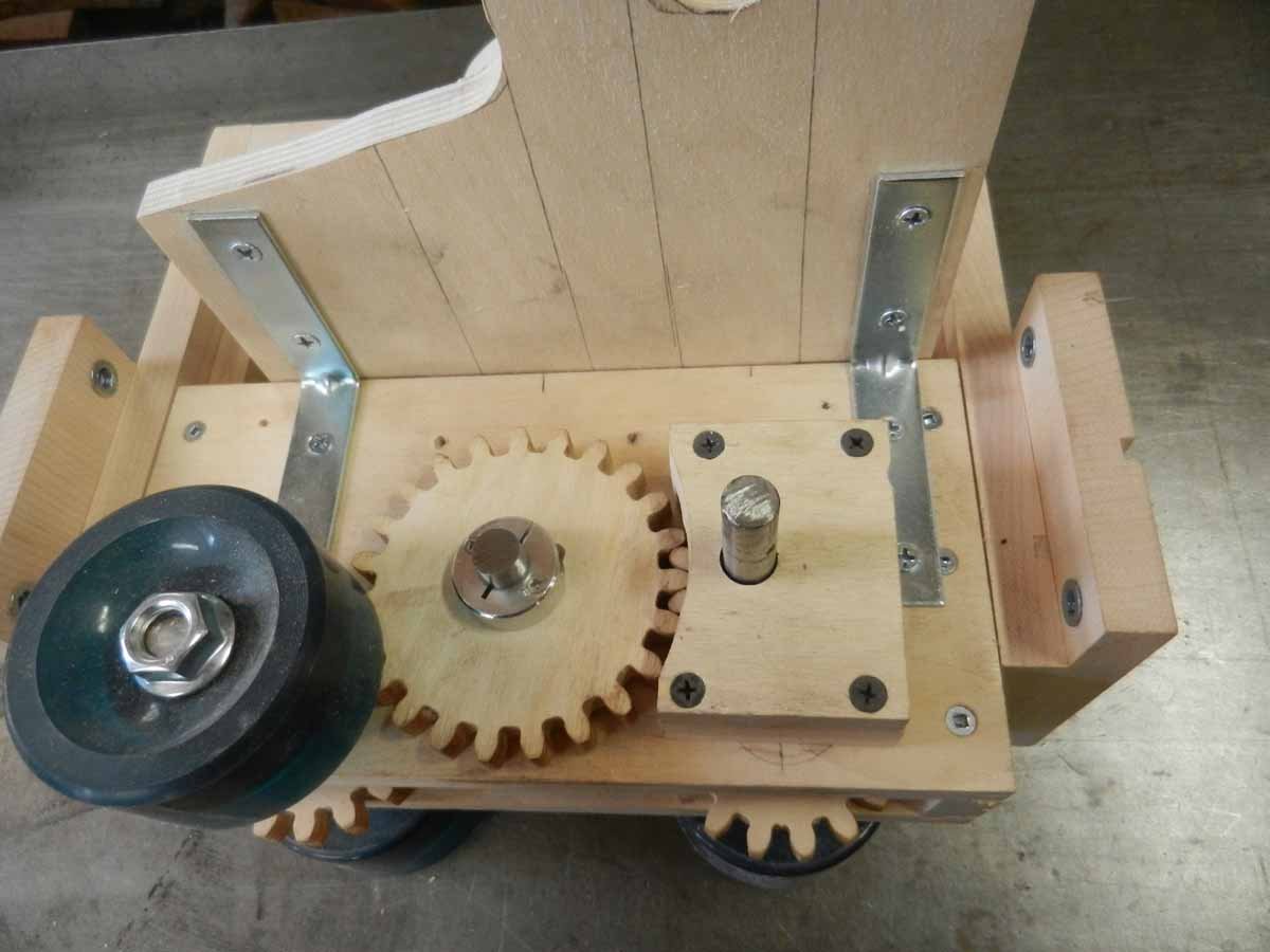

One of my customers, not content with the 4 feet per minute his Dewalt drill gave him, added a third stage of gear reduction, a classic case of thinking outside of the box. I've refined that modification, and will be adding it as an option for an extra $20 or so. For six inch resaw capacity saws it will require two modifications of the pesky feed roller. It changes the gear reduction from 3.8 to ten, so divide those fpm in the chart in the above link by 2.5 with this modification. Even slowed down tenfold, the drill can still give you feed speeds way faster than you can use.
- third stage.jpg (71.79 KiB) Viewed 3490 times
