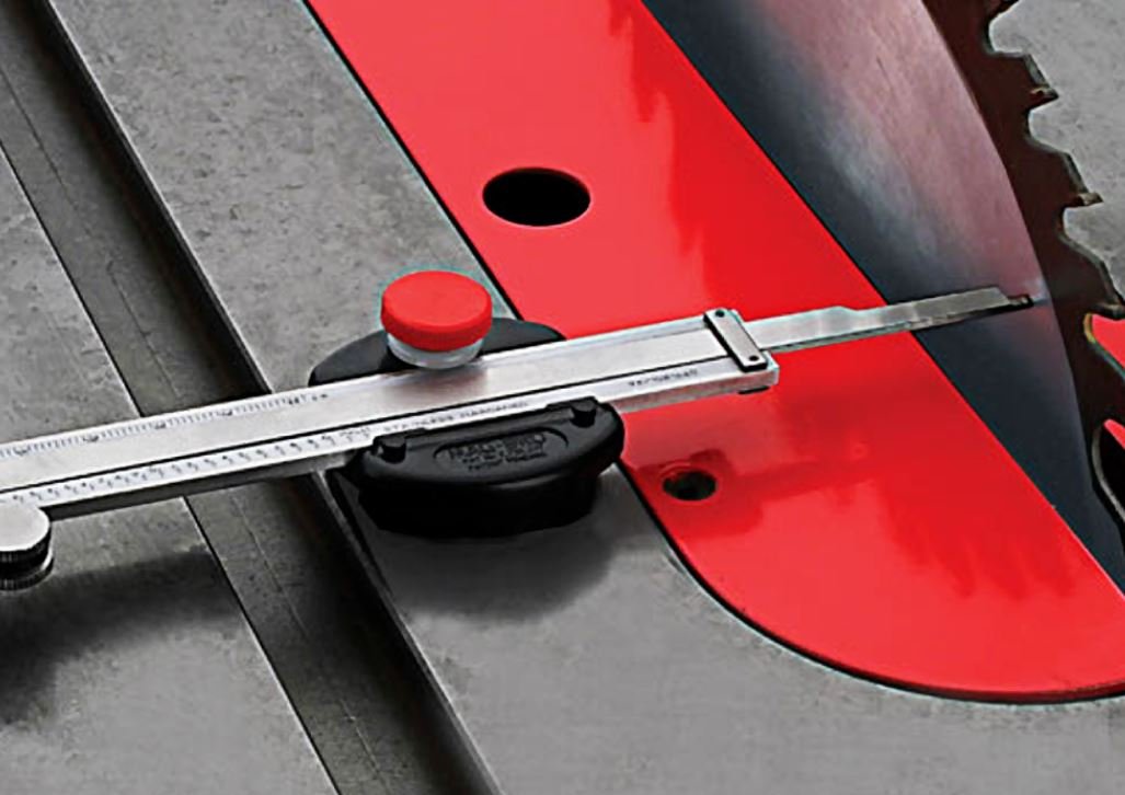

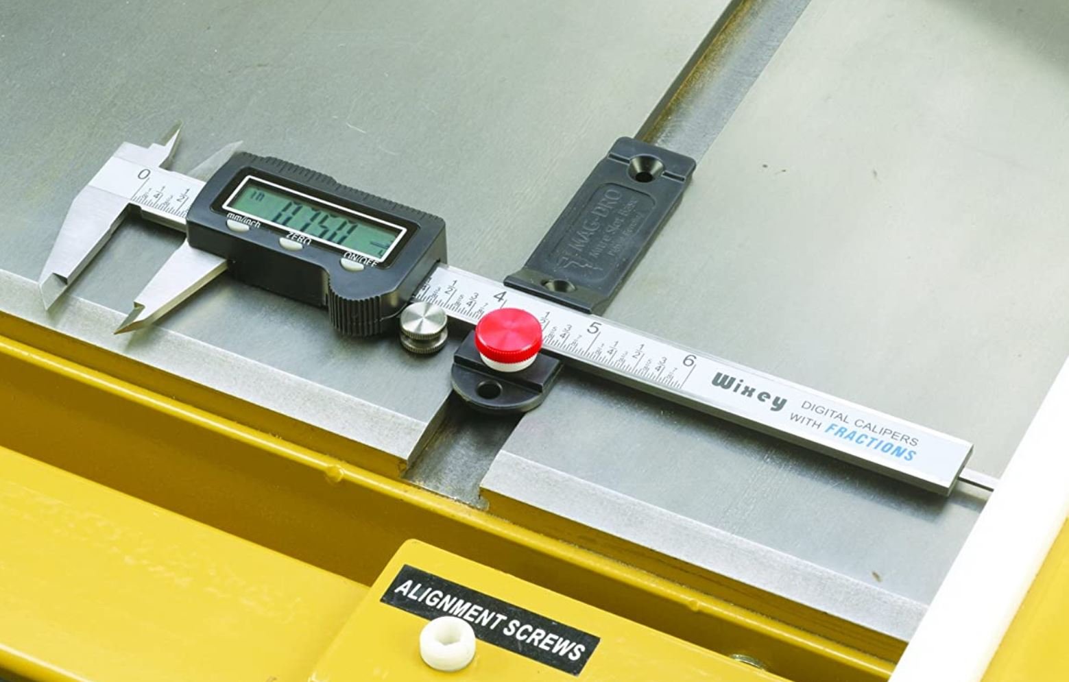

Hi, so for weeks I have been researching and trying to figure out a good method to align my Shopsmith. Seems like a lot of people use dial indicators. I have placed several of these dial indicator tool options in my Amazon cart numerous times. I watched too many YouTube videos to count, and even considered making my own version. Then, by chance, I came across this MAG-DRO tool. It holds your digital caliper and uses the caliper depth gauge to measure the offset from the miter slot to the saw blade, or fence if your trying to mess with that. I happen to live close to a Rockler and they had them in stock, so I bought both options. One type rides in the miter slot, and the other is a magnetic base. It never occurred to me that my table isn't steel, so the magnetic one only works if you stick it to the miter bar, which basically makes it the same as the miter slot version. Below are pics from the internet. Basically, it confirmed what I already thought. Even when I get the alignment perfect, the design of the "moving table" is tough to overcome. I can purposely misalign the table by hand pretty easily. This isn't horrible, but now I know that for critical cuts, I will need to align just prior to each cut. So anyway, I have seen options for tools like this (SuperBar, A-Line, etc.) from $55 up to and over $130, and if you have a high accuracy saw those are probably well worth the money, but I found this little $9 tool does the job better than my saw can maintain. Just wanted to throw out this low-cost option as a search didn't turn up any hits. Bummer the magnetic one wont work out as I intended to use it, but for $10 I am keeping it anyway.

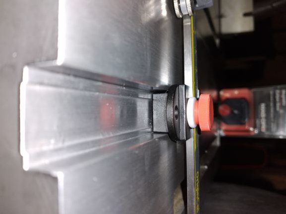

Mike, I just looked at the product description on the Rockler site, and it says that the miter-slot version is for 3/4” miter slots. How are you getting it to work in a Shopsmith miter slot?
Re: MAG-DRO Alignment Tool Option
Hi Dennis, it fits. It has plastic tabs on the sides that act like springs. It is a tight fit, but it does fit and slides in the miter slot.

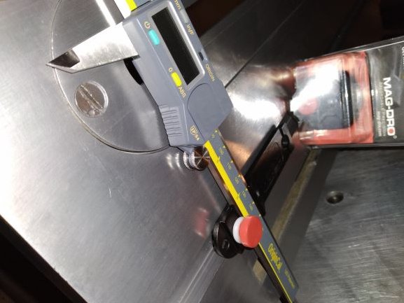

Dennis, a couple more pics of it installed on my SS table. Sorry, I don't know why the pictures rotate, but you get the point.

Yes, that is why I am keeping the magnetic base version as well. I am pretty sure I will use it for something. It is only plastic, so I am thinking with some use it will wear a bit and slide easier in the miter slot.BuckeyeDennis wrote: ↑Tue Apr 13, 2021 10:45 pm Cool! I think I’ll get one to try with my next Rockler order. I’m thinking that it may have uses that go beyond just machine alignment.

Re picture orientation, it is a "feature" of the phpBBS software,
The easiest way to deal with it is to take all your pictures with the phone in the "landscape" orientation.

It is a feature of using a phone for a camera.
A camera does not play the orientation game.
Neither does the forum software.
