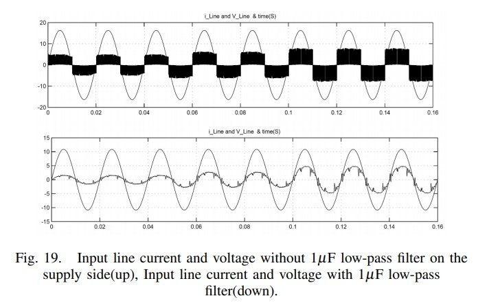

I don't disagree with you on the unbalanced vs. balanced line differences in filter design and a leaking cap (in a filter) could theoretically trip a GFCI, i.e. a bad filter design could make things worse. Honestly I don't know the internals of an AFCI breaker so I am just speculating here. Any switched power supply is notoriously noisy and backfeeds noise and spurious harmonics into the supply main. Below is a graph from a published paper I previously pointed out here on the forum. In the graph, the top is the input line current & voltage going into the power supply for a switched reluctance motor design (should be similar to the PowerPro because it is also a switched reluctance motor), while the bottom graph shows the difference with a 1µF low pass filter added. As you can see in these graphs, the input supply is significantly cleaner on the filtered one. I suspect the spurious harmonics and noise getting back to an AFCI breaker from the PowerPro are causing the "nuisance tripping" and coincidentally this is also what is causing the radio interference experienced by some PowerPro owners. In a switched mode power supply, very large currents are being switched in/out of storage elements (L's and C's). Unfortunately the switches (FET) aren't ideal so there is a ramp as well as transit time to consider but also leakage currents due to parasitics in the storage elements. Because of this, it is possible that the hot and neutral current waveforms may not mirror each other over brief transients thus tripping the AFCI/GFCI. Filtering on the supply side of the PowerPro serves to not only significantly reduce noise & spurious harmonics, but also serves to provide a source of local charge to supply any short term transients due to the PowerPro - preventing the AFCI from even seeing them. At least, this is my theory and what I am going with at this time...

I am curious how a capacitor by itself performs a LOW pass function?
