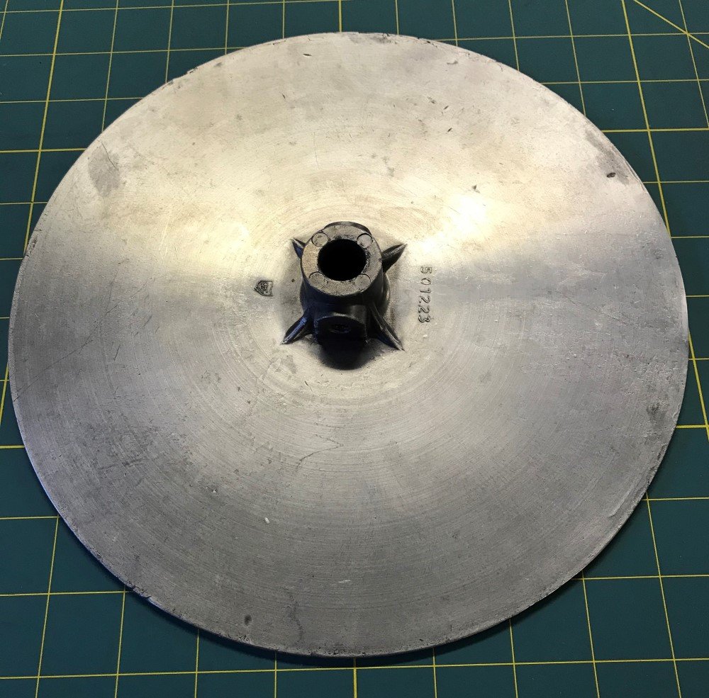

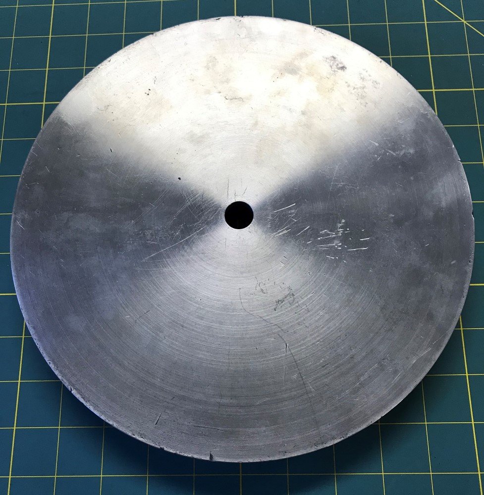

Was this 10" sanding disc flat steel, or cast? JPG mentions a conical version as well. Does anyone have a useful photo or illustration?
I can't see a cast disc fitting into the VII's main table slot without the dado insert, or the aux slot at all.

The 10" Dual Sided Sanding Disk made for the Mark VII is cast aluminum. It is not as thick or "beefy" as the 12" or 9" Sanding disks. It narrows down to less than an 1/8" at the outside edge. The hub side is conical but not as much as the current 12" Conical Sanding Disk. JPG may remember the actual degree. It is shown in the pictures below.

hub/conical side
hub/conical side
501223 10 inch Sanding Disk back.jpg (199.53 KiB) Viewed 4336 times
flat/face side
flat/face side
501223 10 inch Sanding Disk face.jpg (201.75 KiB) Viewed 4336 times

To be able to use the back/hub side for conical sanding the paper (if installed) on the face/flat side needs to have a hole in the center so the disk can be put on the spindle with the hub out.

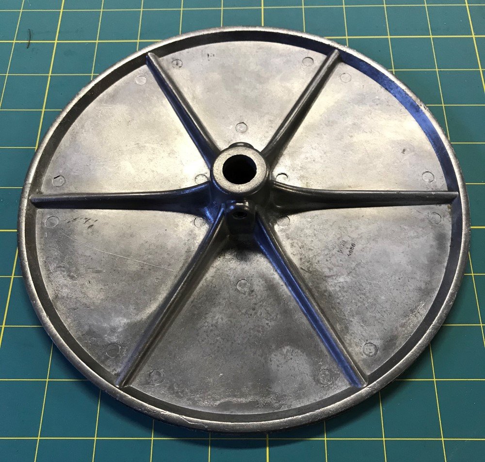

The 9" Sanding Disk is a smaller diameter version of the early 12" aluminum Sanding Disk and is shown in the picture below.
27101 9 inch Sanding Disk.jpg (221.12 KiB) Viewed 4336 times
