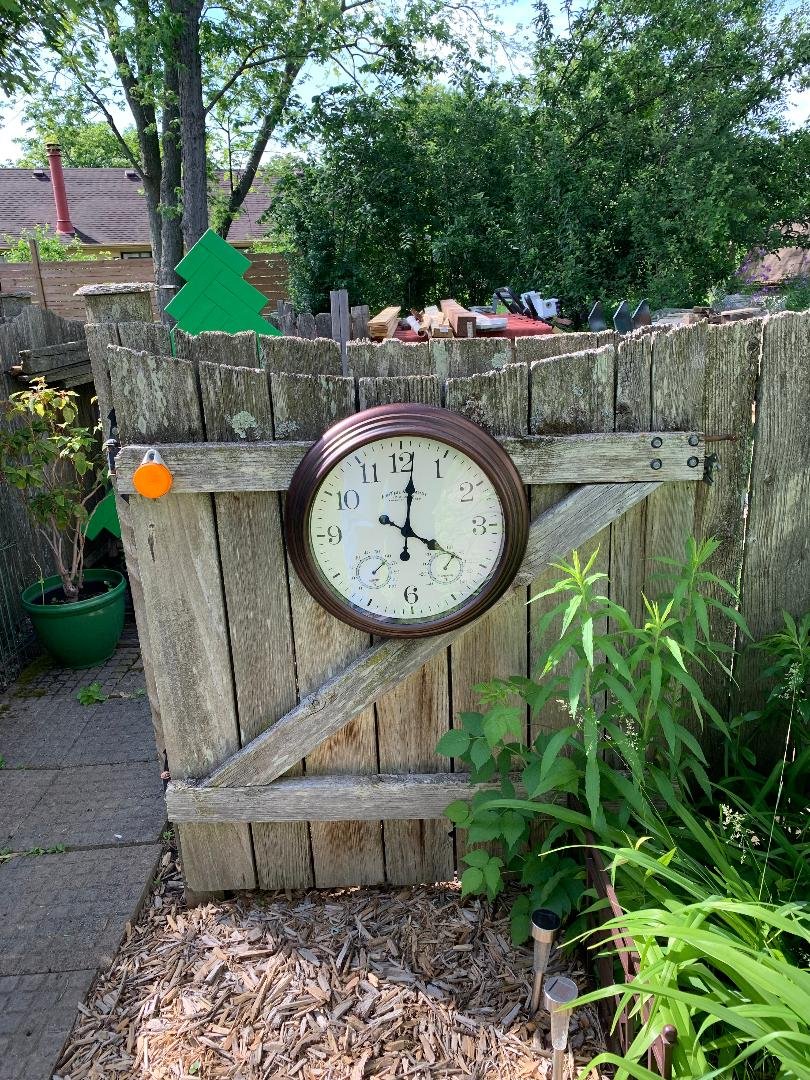

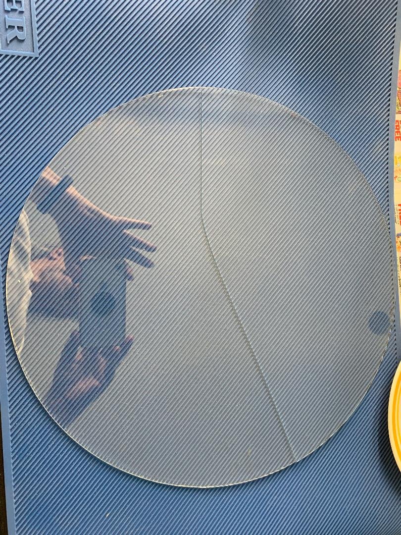

We have/well had an out door clock and the motor needed replacing, which I did. But in the process I broke the glass.
Measures in at 14-5/16 but I guess it could be a 1/16" smaller and still fit. The outside has screws that pretty much says it can't be too much larger but again maybe I could go a 1/16" over.
Clock new was about $30 and now with the new motor I hate to trash it.
Anyone had to deal with this sort of thing and if so what did you end up doing?

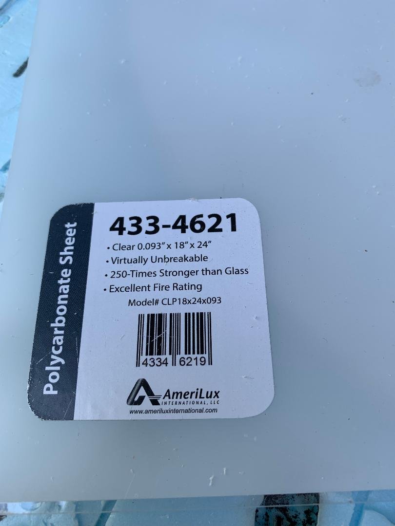

It looks like it was going to cost me about $20 for the repair so I went the route of replacing the glass with plastic. I got this stuff at my local Menard's store for about $20.

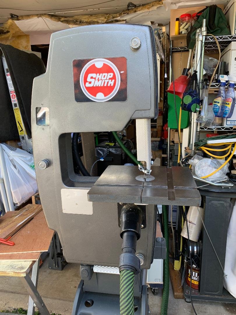

Decided to cut it with the bandsaw. Powerpro menu said 400 rpm which turned out to a really good speed for the cutting.

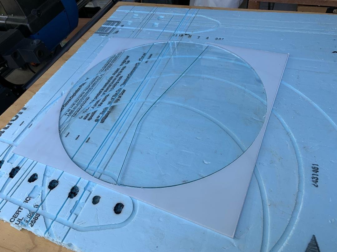

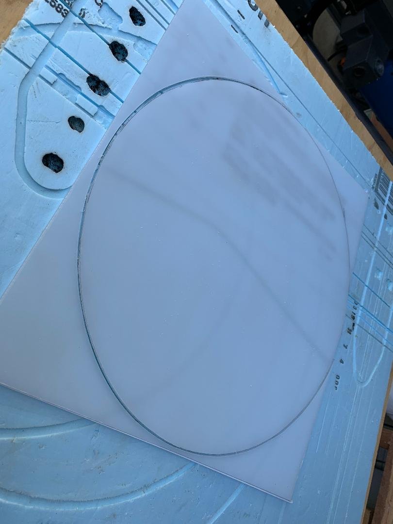

Used the broken glass as a pattern and cut the plastic on the line as best I could. There was some leeway so I wasn't worried.
Pealed the protective cover and put it back together, and it is now back hanging out where it had been.
